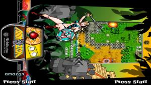

jrose1184 Posted March 14, 2015 Posted March 14, 2015 hi im using jeepguy81 cocktail settup from the ftp download works great apart from i got a arrow on the scrren that keeps coming and going. how can i remove this? thanks
32assassin Posted March 14, 2015 Posted March 14, 2015 that is the pointer image. if you don't wan it you can remove the image found in Hyerpsin\Media\Your cocktail\Images\Other\Pointer.(swf or png) what you should do is adjust the position of the pointer in HyperHQ; so that they appear in the correct place. Look at jeepguys video http://www.hyperspin-fe.com/forum/showthread.php?10242-Cocktail-cab-themes he has them by the wheel image positions.
