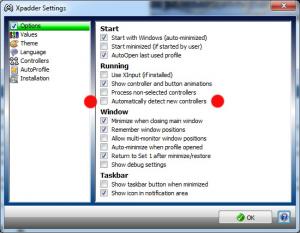

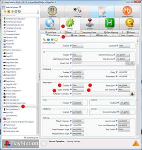

You don't need to use xpadder of course, you either need a blank profile or just turn off keymapping for that system.
