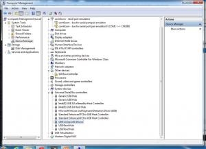

JoeC3109 Posted April 3, 2015 Posted April 3, 2015 Hey everyone, I think I might have found a way to disable the Dolphinbar by just running a batch file, and then running another batch file to enable it. I'll need some people to verify something for me however, and that is the hardware ID of their dolphinbars. Hopefully it's the same for everyone, so then I could just share my batch files and it could be accessible for everyone. A few people could help me out by going to this site: http://www.classicshell.net/forum/viewtopic.php?f=5&t=423, read Step 4, and then reporting here what the hardware ID is for their dolphinbar. Also, the dolphinbar comes up as "USB Composite Device" for me if that's helpful. Any feedback would be appreciated.
Dime333 Posted April 3, 2015 Posted April 3, 2015 Could you post a screenshot of the device manager showing where you found the dolphinbar?
JoeC3109 Posted April 3, 2015 Author Posted April 3, 2015 In case anyone needs help on how to get there. Click Start on Windows Right Click on Computer, and then click Manage Device Manager will be an option on the left

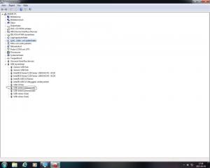

Dime333 Posted April 3, 2015 Posted April 3, 2015 Thanks. I still have no clue which one is the Dolphinbar on my cab though.

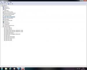

vampirolatino2 Posted April 3, 2015 Posted April 3, 2015 Thanks. I still have no clue which one is the Dolphinbar on my cab though.[ATTACH=CONFIG]52603[/ATTACH] There are other solutions, but just for a quickuie ... now that you have that screenshot, now unplug it and take a screenshot ... now compare and see what's different. That should be the Dolphinbar. Then you can go to details and find the ID.

Dime333 Posted April 3, 2015 Posted April 3, 2015 OK. Thanks. It's gotta be this one, then. ID is: USB\VID_057E&PID_0306&REV_0100 USB\VID_057E&PID_0306
