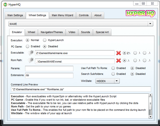

justice999 Posted September 19, 2015 Posted September 19, 2015 Look at EXECUTION and PC GAME, it may helps.
repsolryder Posted February 20, 2017 Posted February 20, 2017 On Saturday, September 19, 2015 at 6:55 AM, justice999 said: Look at EXECUTION and PC GAME, it may helps. Thanks Justice999, it helped with my HLSL in HyperSpin 1.4.16
