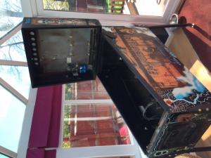

After months of deliberation I have decided to give it a go and have found a donor cabinet to start my build (picture attached)

hi mayo welcome to the forums...
you can use a vertical display for the backglass and dmd, quite a few people have done this in the past, just check back through some of the builds in this forum.
the R9 shouldn't have any problems with running the 2 screens in the configuration you require.
run windows 7 (or 8 if you like) for the o/s and put the hyperpin shortcut into the startup directory.
shelling windows 7 can be done (hiding all of the tell tale signs of windows) , just google for some examples..
i myself removed the startup (starting windows 7 screen out) but kept the windows interface (in case i need to make changes later) i just made custom backbox and playfield screens to match the rest of my pin.
using an ssd the system boots into hyperpin so fast you hardly even get to see them.
i hope this helps.
any other questions please feel free to ask..
