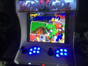

I am building my first Hyperspin setup. I have purchased Xpadder and i am trying to wrap my head around the process of setting up controls. (2 Joystick and 12 player buttons, 2 pinball buttons, player select button and coin up button)
I have got MAME working and the Hyperspin menus for my controls.
How do i proceed? i think MAME was the easy one to setup in my system. Now i am facing problems with the other Emulators, because i have set the 1st button, the shooting button up for ENTER in hyperspin. This seems to follow around when i load another emulator?
Is there anyway to un-load the hyperspin controls when entering an emulator? and the reactivate the hyperspin control setup when exiting the emulator.
