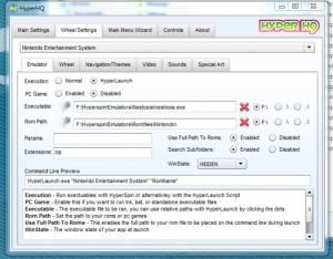

mameshane Posted February 12, 2013 Posted February 12, 2013 1. does the rom exist in the roms folder? has to be named correctly. 2. is it the same file extension u specified when setting up system in hyperhq? My Cab.. 1-UP ARCADE new hyperspin irc details.. come hang out!
mustangmatt Posted February 12, 2013 Author Posted February 12, 2013 yes the rom is in the folder and plays when not in hyperspin and yes i went in to the wheel settings and set it up to that path
mameshane Posted February 12, 2013 Posted February 12, 2013 screen shot the rom folder directory My Cab.. 1-UP ARCADE new hyperspin irc details.. come hang out!
mustangmatt Posted February 12, 2013 Author Posted February 12, 2013 i dont want to sound stupid how do i do that?
mameshane Posted February 12, 2013 Posted February 12, 2013 press your print screen button then paste into the paint application. crop and resize best u can. save then upload My Cab.. 1-UP ARCADE new hyperspin irc details.. come hang out!
mustangmatt Posted February 12, 2013 Author Posted February 12, 2013 there we go thank you for being so patient i'm a noob
