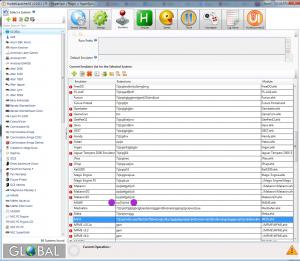

Is that error message coming from HyperSpin or HyperLaunch? You probably need to add the Rom extension to the list in HyperLaunchHQ under Global. It will depend on the system and whether the zip needs extracting or not, Mame will be just zip|7z|chd, something like MESS will have a very long list of extensions.
If that doesn't fix things please post your logs.
