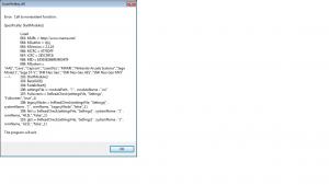

CanadianRyGuy Posted May 30, 2015 Posted May 30, 2015 Hello Everyone, Not sure if anyone else has gotten the error window pop when trying to load any MAME game through HyperSpin. I've attached a picture of the message. If anyone can explain what to do or point me in the right direction, I would be very grateful. Cheers, Ryan.

nobita Posted June 7, 2015 Posted June 7, 2015 Hi again, i can resolve the problem with MAME replacing the archive of MAME's module (MAME.ahk) with the original file include in the hyperspin 1.3.3 download. The file include in Rocketlauncher it seem be the problem and the updates don't help.
mikty Posted June 8, 2015 Posted June 8, 2015 Hi again, i can resolve the problem with MAME replacing the archive of MAME's module (MAME.ahk) with the original file include in the hyperspin 1.3.3 download. The file include in Rocketlauncher it seem be the problem and the updates don't help. cool ,I will have a look on this thanks
