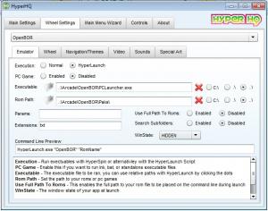

SIMPLYAUSTIN Posted June 23, 2015 Posted June 23, 2015 HyperHQ. Make sure you extension match exactly with what you have in the rom folder its pointing at Simply Austin's YouTube

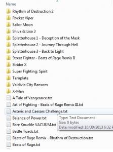

wizshaw Posted June 23, 2015 Author Posted June 23, 2015 Ive included my setup below. In the extension box it was txt to match the files I made. The files themselves are empty though. A little more guidance would be great, thanks for your help. Chris
wizshaw Posted June 23, 2015 Author Posted June 23, 2015 Ive went ahead and made a super small database file with only one game in it to try and weed out any complications. And it still boots me out of the menu. I personally dont see how the extensions would have anything to do with this, as it has nothing to do with launching the titles. I just want to get into the wheel, but it starts to transition over, then boots me instantly out to the main wheel again. Any help would be great. Once I understand the problem, I can fix "Touhou project" as well. Which uses pclauncher. I also inspected popcap. Which also uses pclauncher. I dont see any glaring differences.
wizshaw Posted June 23, 2015 Author Posted June 23, 2015 I solved it. I removed OpenBOR from HyperHQ, then just readded it. Everything seems to launch now.
