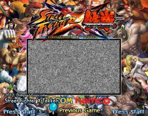

MacklinB Posted March 31, 2013 Posted March 31, 2013 I've looked around and made sure that this isn't a thing that can already be done, but excuse me if there's some way you can actually do this in HyperSpin. Right now in HyperSpin you have a per-system option to either show info for all games (as in the Genre, Year, Manufacturer, Title shown in the lower left by default) via "remove_info_text". For games using the systems Default theme, this is completely fine -space wise- but more often than not, themes makers will try to stuff lots of art into a space that is restricted by text that - to be honest - is useless when a theme exists for the game, given that themes usually exhibit the title of the game and/or the manufacturer. Since remove_info_text is false by default for all newly installed systems, themes tend to either be designed around all this extraneous text - which limits the amount space actually used for art - or designed in a way that completely ignores all the UI placement, which ends up with UI text overlapping artwork, logos, videos and whatnot. Not good. I sometimes find myself manually editing many user-created themes so that the art and videos contained withe them isn't obscured by game info. Take for example: One simple way to avoid this is to add a toggle-able option which will hide or show info_text and info_wheel depending on if a theme exists for the game or not. Think of it as fullscreen themes - leaving the user to experience the entirety of the theme, rather than having obscuring text. It's a matter of personal preference, really. Maybe alternatively there could be an option to fade in said information after the theme has finished animating in or after a predefined amount of time? Sure, I don't see this option being overly time-saving when looking for one game in thousands of themed games of a system - as you'd need to wait until after the theme has animated in until the game information appears. But I'm sure most people can quickly determine what a game is by its wheel art - and besides - with the upcoming search feature you won't have to do that! I also just noticed that in HS1.3 "remove_info_wheel" and "remove_info_text" does pretty much nothing in my MAME wheel. Does it not do what I'm assuming it does? Atari 2600: Wheels (FTP) + Wheels (Cart Labels) (FTP) | Emerson Arcadia 2001: Wheels (FTP) | Future Pinball: Wheels + Flyers + XML (FTP) | PlayStation 1: ePSXe Guide | Sharp MZ-2500: XML | Sinclair ZX Spectrum: XML | Touhou Project: Themes | FTP

RonnieLloyd Posted June 13, 2013 Posted June 13, 2013 I've looked around and made sure that this isn't a thing that can already be done, but excuse me if there's some way you can actually do this in HyperSpin.Right now in HyperSpin you have a per-system option to either show info for all games (as in the Genre, Year, Manufacturer, Title shown in the lower left by default) via "remove_info_text". For games using the systems Default theme, this is completely fine -space wise- but more often than not, themes makers will try to stuff lots of art into a space that is restricted by text that - to be honest - is useless when a theme exists for the game, given that themes usually exhibit the title of the game and/or the manufacturer. Since remove_info_text is false by default for all newly installed systems, themes tend to either be designed around all this extraneous text - which limits the amount space actually used for art - or designed in a way that completely ignores all the UI placement, which ends up with UI text overlapping artwork, logos, videos and whatnot. Not good. I sometimes find myself manually editing many user-created themes so that the art and videos contained withe them isn't obscured by game info. Take for example: [ATTACH=CONFIG]25461[/ATTACH] One simple way to avoid this is to add a toggle-able option which will hide or show info_text and info_wheel depending on if hid kits theme exists for the game or not. Think of it as fullscreen themes - leaving the user to experience the entirety of the theme, rather than having obscuring text. It's a matter of personal preference, really. Maybe alternatively there could be an option to fade in said information after the theme has finished animating in or after a predefined amount of time? Sure, I don't see this option being overly time-saving when looking for one game in thousands of themed games of a system - as you'd need to wait until after the theme has animated in until the game information appears. But I'm sure most people can quickly determine what a game is by its wheel art - and besides - with the upcoming search feature you won't have to do that! I also just noticed that in HS1.3 "remove_info_wheel" and "remove_info_text" does pretty much nothing in my MAME wheel. Does it not do what I'm assuming it does? There is nothing like removing text you can just edit some settings nothing else.. I think there are some options to make your hyperspin better. Check it..
