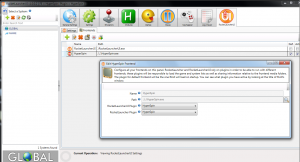

  • Look in the left near the top of the RocketLauncherUI main window for the words "Select a System" under it you should see a button that looks like two green arrows making a circle. Click on the circular green arrows button to refresh the systems list to match the active frontend.
The HyperSpin frontend was already created. I attached a screenshot to verify. It was not set as the active or default so I have done that per your instructions.
Same results. HyperSpin starts up fine, I can scroll through all the roms, but they do not start when I hit enter (I have checked the input to ensure 'Enter' is select). Roms can still be run straight from MAME so those are good.

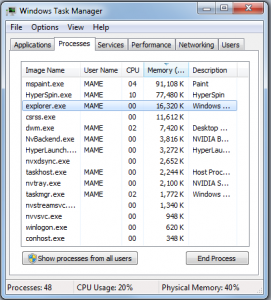

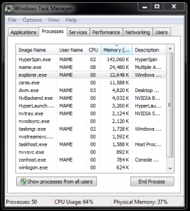

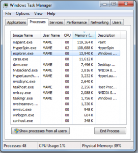

Can you also post a screenshot of the processes tab in task manager (ctrl + shift + escape to bring it up). I specifically want to see if either the rocketlauncher process is still running or if the emulator is still running. Do this when it fails to start after the first time.
So I found how I can get the 'one hit wonder.' I need to kill the HyperLaunch task. I can still only run a rom once though. I have attached a picture of after the rom starts and is running (running), after I exit the rom (after running), and when I try to run it again (not running).
Like before, I "do not have permission to upload" the type of file for the Rocklaunch log so I'll paste it in here. I'll remove it once you view it.
Again, if I kill the HyperLaunch process, I can start a rom again. But once I exit that rom, I cannot start another rom without killing the HyperLaunch process.
