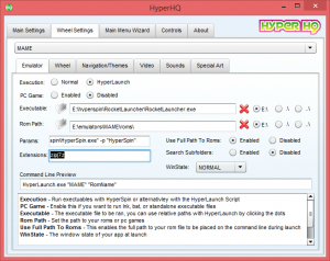

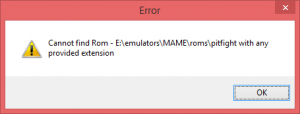

hyperdennis Posted June 26, 2015 Posted June 26, 2015 hi guys, need some advice on where to look because i think my settings are correct. When i try to start a game from hyperspin i get a error : Cannot find rom with any provided extension. When i open RLUI, i can launch any game from the system audit screen. In the HYPERHQ app, i've setup the correct rom path and the correct extions. IN the hyperspin directory, mame.ini is also correctly setup So what more should i check now? (Yes, i do have the roms inside that directory)
baddeolv Posted June 26, 2015 Posted June 26, 2015 In rlui set skip checks to "rom only". Also disable 7z for mame Sent from my iPhone using Tapatalk Instagram : baddeolv Facebook : Brian Addeo
gigapig Posted June 26, 2015 Posted June 26, 2015 I can't tell if you have run the transition tool or not as the parameters don't look right, execution should be set to normal, Rom path and exetension must not be set. Go back to the Transition tool page and read section 3b.
hyperdennis Posted June 26, 2015 Author Posted June 26, 2015 the problem was solved with setting the execution to normal THANKS FOR THE HELP!!
