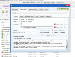

legoman195 Posted June 27, 2015 Posted June 27, 2015 Dear all, As I try to enter Mame from hyperspin im getting pushed out. Its like there is nothing in mame but i have all the themes and videos. hyperspin will let me in other emulators but not MAME. I have spent hours on this and I m considering a reinstall to see if it helps but would rather not for the time being. I have attached a file to better show the problem. has anyone had this problem? Thanks, Lego problems with MAME.wmv

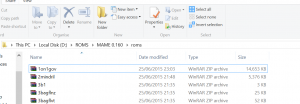

legoman195 Posted June 27, 2015 Author Posted June 27, 2015 both rom path and extensions are as attached and seem to be fine. I have changed my data base twice to try and sort the problem but same result. all roms work fine though MAME and rocketlauncher
legoman195 Posted June 27, 2015 Author Posted June 27, 2015 No the 1.3.2.0 v Good question though..... I would love it to be someone else's fault and not my constant tinkering! In the databases MAME is just that isnt it Ive not named it wrong have I?
gigapig Posted June 27, 2015 Posted June 27, 2015 Why the hell is RocketLauncher.exe in the root HyperSpin folder? It should be in its own folder. And judging by your screen shot of HyperHQ you haven't run the Transition tool. As Jeremy will tell you, you're better of using the 1.4 beta which has been set up any launcher not just HyperLaunch.
