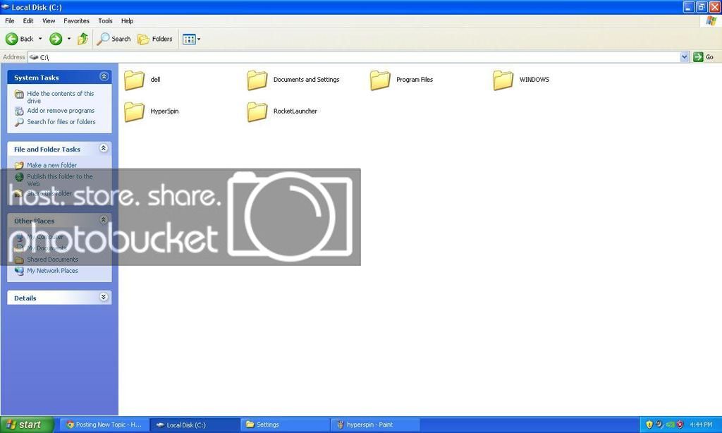

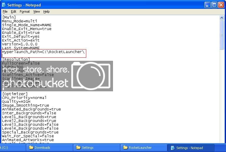

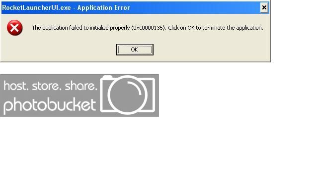

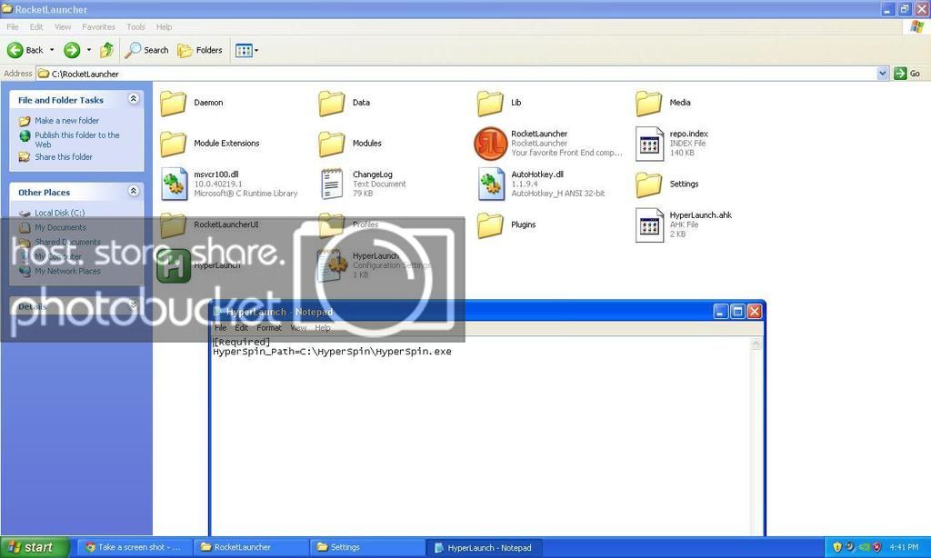

uz1290 Posted July 2, 2015 Posted July 2, 2015 Hi all, New member here. I am having some issues getting past what seems to be simple task. I am following this guide: http://www.hyperspin-fe.com/topic/2187-how-to-install-hyperspin/ I get to step 6 in the guide where I am supposed to launch RocketLauncherUI, but seem to not be doing something right. I get an error message indicating that the UI exe file fails to launch correctly. I extracted the compatibility fix and all into my rocketlauncher folder. Could someone quickly verify I am setting my paths correctly and have extracted my folders correctly? I hope this doesn't seem extremely simple of me to ask, but this is the third time I've completely deleted everything and reinstalled. I believe it's something small I'm overlooking on my part. I would greatly appreciate the help. Thanks!

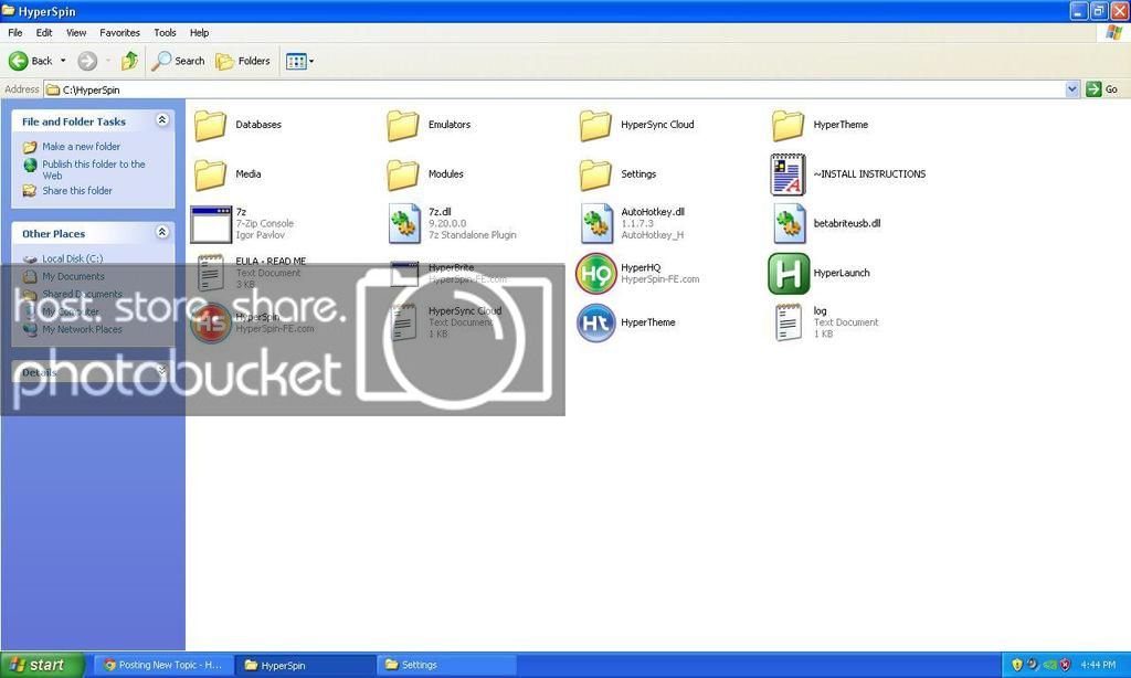

32assassin Posted July 2, 2015 Posted July 2, 2015 where did the Rocketlauncher/Hyperlaunch.exe Rocketlauncher/Hyperlaunch.ahk Rocketlauncher/Hyperlaunch.ini come from? this does not belong here, since you are using Rocketlaucher they do not belong in your PC. you can also delete Hyperspin/Hyperlaunch.exe Hyperspin/Hyperlaunch.ahk Hyperspin/Modules Hyperspin/7z.dll Hyperspin/7z.exe Hyperspin/Autohotkey.dll Hyperspin/~ Install Instructions do you have Netframework 4.0 installed?
uz1290 Posted July 2, 2015 Author Posted July 2, 2015 hyperlaunch does not equal rocketlauncher. But it seems you may have something else going on as well. Thanks for the response. Are you referring to the path under the ini settings file?
ghutch92 Posted July 2, 2015 Posted July 2, 2015 It looks like you are on Windows XP. You will need Service Pack 3 and .Net Framework 4.0 https://www.microsoft.com/en-us/download/details.aspx?id=17851 The HyperLaunch he/she is using is not actually hyperlaunch but just an executable that forwards commands from HyperSpin to RocketLauncher. HyperSpin 1.3.3 and below need a proxy executable or the rocketlauncher transition tool. The proxy executable is less of a headache to deal with in the long run and in the short term than the transition tool. How to Install HyperSpin and more RocketLauncher HyperSpin Startup Script

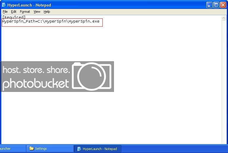

uz1290 Posted July 2, 2015 Author Posted July 2, 2015 where did the Rocketlauncher/Hyperlaunch.exe Rocketlauncher/Hyperlaunch.ahk Rocketlauncher/Hyperlaunch.ini come from? this does not belong here, since you are using Rocketlaucher they do not belong in your PC. you can also delete Hyperspin/Hyperlaunch.exe Hyperspin/Hyperlaunch.ahk Hyperspin/Modules Hyperspin/7z.dll Hyperspin/7z.exe Hyperspin/Autohotkey.dll Hyperspin/~ Install Instructions do you have Netframework 4.0 installed? Those rocket launcher files are what was extracted from the Hyperspin and RocketLauncher Compatibility Fix.zip in step 5. I was supposed to launch the exe contained in there and was supposed to change the path in the hyperlauch file. Great, will clean up the folder, As far as Netframwork 4.0 I'm pretty sure i don't as I just recently installed a fresh copy of XP on my pc. Is this something I need to correctly set up Hyperspin? I apologize for the question, but the guides I am referring to didn't seem to mention this so just wondering.
uz1290 Posted July 2, 2015 Author Posted July 2, 2015 It looks like you are on Windows XP. You will need Service Pack 3 and .Net Framework 4.0 https://www.microsoft.com/en-us/download/details.aspx?id=17851 The HyperLaunch he/she is using is not actually hyperlaunch but just an executable that forwards commands from HyperSpin to RocketLauncher. HyperSpin 1.3.3 and below need a proxy executable or the rocketlauncher transition tool. The proxy executable is less of a headache to deal with in the long run and in the short term than the transition tool. You are indeed correct. Thank you for the suggestions! Will refer to the links you provided. I will report back with my results once I've gone through those.

uz1290 Posted July 3, 2015 Author Posted July 3, 2015 Thanks for all the help thus far guys. Y'all were right about needing the NET framework 4.0. I was able to go through the entire install guide. Just need to setup my roms correctly now. If its of any interest to anyone, I was receiving a "cannot read from a closed text reader error" when attempting to apply the updates to rocket launcher. I had to update my rocket launcher Ui to the one in the followig thread: http://www.rlauncher.com/forum/showthread.php?970-error-Cannot-read-from-a-closed-text-reader/page2
