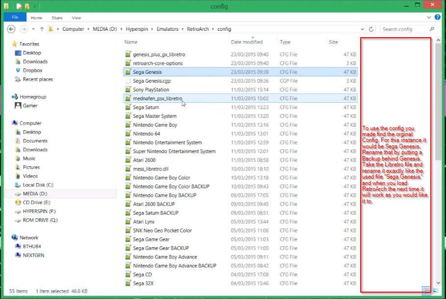

Guest rynoman03 Posted July 14, 2016 Posted July 14, 2016 Got it. I got ahold of SimplyAusin as well. He told me to re-watch his RA video. I found what I was missing. I knew you had to make the change in RA then save the config but I wasn't understanding how to use the config once changed. I get it now Thanks mate! PS: I made a little snippet below in case others have the same issue.
