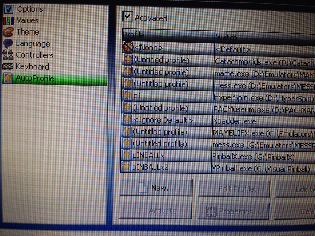

i use xpadder. I have it start up automatically with the PC. I have a Player1 profile setup to open when Hyperspin.exe is started. and I have a blank profile with no keys assigned to set for every emulator .exe file in auto profile for xpadder. the blank profile allows me to setup my controls in the emulator for my controller that I use. by doin this it allows ur controller to be used as normal. works great with my setup. 563868d277d8e20388460a0728be37e6.jpg
