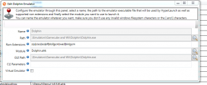

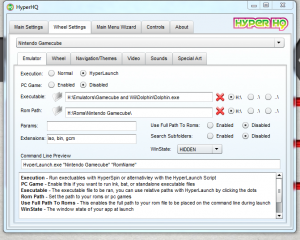

bcolon91 Posted July 6, 2015 Posted July 6, 2015 Hi I have been having an issue with .GCM roms not showing up in my game wheel, I double checked the names of the roms against the database and they are correct, my .ISO roms show up perfectly within the wheel. I made sure to add the .GCM extension to both hyperhq and hyperlaunchhq. I am using Dolphin as the emulator. any help would be great.

bcolon91 Posted July 6, 2015 Author Posted July 6, 2015 I checked, all the gcm files are all lowercase, no caps at all. But just for the heck of it, I renamed the gcm file extension to the iso extension, and the game loads fine within dolphin and also comes up in my wheel as well. I'm not sure if they are any negative side effects of changing the extension like that?
