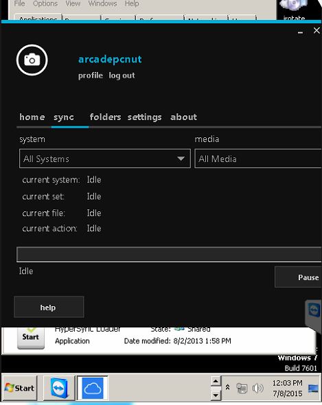

The software is designed specifically not to be resizable. So I cant even grab the bar and move some of it offscreen to sync. I can understand maybe having to setup and configure it once in a higher resolution. but every time I want to sync on my vertical cab I have to basically screw up my machine to see the sync button wheich is just left of pause in the screenshot but if you drag the application over to get to sync sync is gone due to it specifically not drawing offscreen graphics. the hypersync has to be coded this way on purpose cause other programs I can move left and right to get to what I need to on such a small screen.

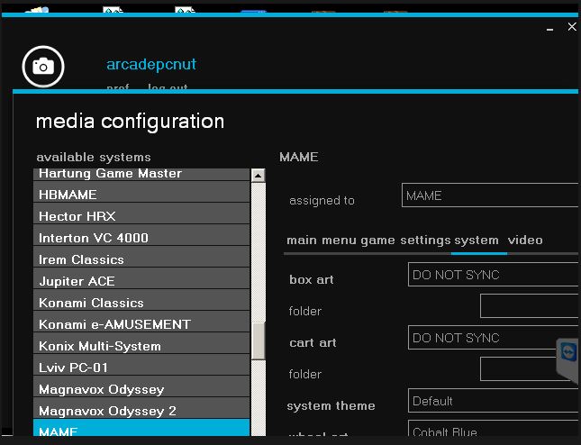

Im just now setting up my horizontal cab and trying to configure it. attached it pictures. I cant be the only one using real 27" crts?!?!
