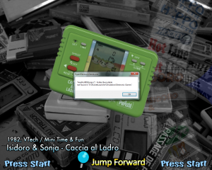

Dime333 Posted March 10, 2016 Posted March 10, 2016 I found some more game issues. The "shoot" buttons are not working in Bomb Fight, Hippo Teeth (Large) and Isidoro & Sonja - Cessate il Fuoco. In Flagman, no matter what button I use, The game presses "Game B". Dizzy's Cash in doesn't seem to accept AHK keymapping so I think I'll remove it from my DB. It should still work fine for people who use gamepads I guess. I also get this when trying to run Isidoro & Sonja - Caccia al Ladro. I hope I'm not discouraging you with these suggestions. It's just that i love Perfection Edit: On closer Inspection, Dizzy's Cash In does accept AHK Keymapping. Maby you forgot to do the mapping on that one?

r0man0 Posted April 14, 2016 Author Posted April 14, 2016 I found some more game issues. The "shoot" buttons are not working in Bomb Fight, Hippo Teeth (Large) and Isidoro & Sonja - Cessate il Fuoco. In Flagman, no matter what button I use, The game presses "Game B". Dizzy's Cash in doesn't seem to accept AHK keymapping so I think I'll remove it from my DB. It should still work fine for people who use gamepads I guess. I also get this when trying to run Isidoro & Sonja - Caccia al Ladro. I hope I'm not discouraging you with these suggestions. It's just that i love Perfection Edit: On closer Inspection, Dizzy's Cash In does accept AHK Keymapping. Maby you forgot to do the mapping on that one? Hi , sorry for the delay , i've not been on this topic for a moment ...all errors have been solved , cause it come from the 0.9.7beta version Dizzy's cash in still doesn't works for arcade tanksticks need more investigation... I will update soon main post to 0.9.7 final version with 53 new games added !! Thanks for your reports... r0man0 P.S: i love also perfection
