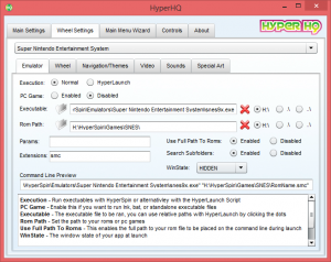

hyperdennis Posted July 12, 2015 Posted July 12, 2015 HI all, i have a working hyperspin setup with mame working - Yaj! Now i am trying to setup my SNES list trouble is that everything is setup right but when i try to do an audit in HyperLaunchHQ, none of the games are found.And i've checked, double checked, triple checked if the rom path to the SNES games is correct. it is in HyperlaunchHQ and HyperHQ. Also in the settings file. And as a result of this that the games do not work from within hyperspin obviously Would some one please advise me on what i should check futher? Thx

hyperdennis Posted July 13, 2015 Author Posted July 13, 2015 I use hyperlaunch. They launch OK in hyperlaunchHQ. I use the games tab > system audit > Launch with So no problem there... Im not sure what the trouble is in hyperspin. I select SNES in the main screen, all the games appear and when i select a game to start, the video pauses, nothing happens and when i use the mouse and click, the video plays on.

hyperdennis Posted July 14, 2015 Author Posted July 14, 2015 that was it! I set the execution to hyperlaunch instead of normal... But i dont understand.. why is this different from (for example) MAME, which needs to have the execution set to normal??
