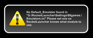

I used the transistion tool to convert hyperlaunch to rocketlauncher.
It didn't work well (tried 5 times)
Most settings are done by transistion tool, except taking the systems over to rocketlauncher. but thats ok for me, because ionly have 79 Systems. So adding them to rocketlauncher is not that problem.
i can start roms from within rocketlauncherui and rocketlauncher.....no problem here.
checked hyperhq.exe..... rl settings are good.
when i try to start a game from within hyperspin it gives me the error on the first pic.

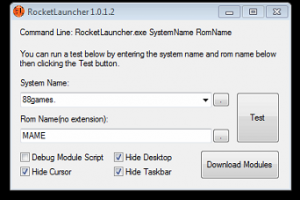

i figured out, that if i start rocketlauncher afterwards, that the rom is shown under "system" and the system is shown under "rom name" (2nd pic)
as i said if i start any game from rocketlauncher.exe or rocketlauncherui.exe, everything is ok..
i checked every ini, which i think is related....no luck... i just can't figure out whats wrong...

This seems to be a common issue with people upgrading. I believe the fix is in an ini file somewhere.
Start reading through the problem with Hyperspin/RocketLauncher thread and you'll probably come across the fix. Good luck.
