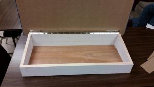

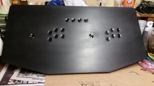

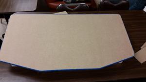

Kenny Powers Posted August 3, 2015 Posted August 3, 2015 I'm attempting to build a gamebox. I want to make a portable system that I can just plug into any tv. Since I have no woodworking tools and lacking the skills I had a friend help construct a box and drill some holes. I'm at the stage of trying to fit everything in the box and wire up the controls. I still don't have any good ideas for the control panel overlay. This seems to be the tough of part of my build since once again I'm lacking the skills with Photoshop or illustrator. If anyone has any sources where I could find some art to use it would be appreciated.
HazzardActual Posted August 3, 2015 Posted August 3, 2015 i think this might help you out. http://www.slagcoin.com/joystick/layout.html looks like a good start, what guts are you putting into it?

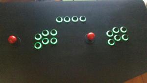

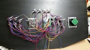

Kenny Powers Posted August 4, 2015 Author Posted August 4, 2015 The photos I posted are not the most up to date. I bought a mini itx PC from eBay. I wanted something small and it had a hdmi port and it was a good price. Here are some newer pics. I'm doing a mock up to get things working.
