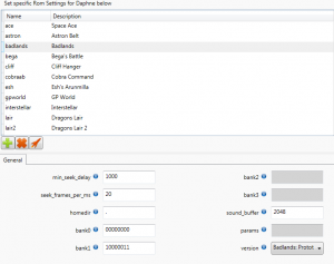

Metalzoic Posted August 30, 2015 Posted August 30, 2015 OK so my Global_Module_Params are: vldp -blank_searches -noissues -fastboot Screen Width set to: 1680 Screen Height: 1050 Pause on Exit: True HWAccel: default Here's the Badlands specific settings. I don't know if these are best, but it seems to work. Runs in the correct ratio on a 1080 16:9 monitor. Maybe Ron or someone else will chime in with their settings. I also just updated RocketLauncher and the Daphne Module is one that changed. Not sure what those changes are yet though. Although I have no idea how to play it. Is it just a shoot button or do you also use the joystick directions like Dragons Lair?

ronor Posted September 10, 2016 Author Posted September 10, 2016 Ok, here they are: DaphneLoader: daphne.exe badlands vldp -framefile framefile\badlands.txt -blank_searches -min_seek_delay 1000 -seek_frames_per_ms 20 -homedir "D:\Arcade\System roms\Daphne" -bank 0 00000000 -bank 1 10000001 -noserversend -sound_buffer 2048 -x 640 -y 480 RLUI: Run - Running: D:\Arcade\System roms\Daphne\daphne.exe badlands vldp -blank_searches -prefer_samples -fullscreen -noissues -opengl -fastboot -x 1024 -y 768 -opengl -fullscreen -x 1680 -y 1050 -min_seek_delay 1000 -seek_frames_per_ms 20 -homedir . -bank 1 10000011 -sound_buffer 2048 -framefile "D:\Arcade\System roms\Daphne\framefile\badlands.txt"
ronor Posted September 10, 2016 Author Posted September 10, 2016 Also, when I launch Badlands through DL, I get 5 lives/ coin. When launching through RL, I get 7 lives/ coin. It's like I'm not editing the correct config files or there are two different instances of Daphne.
