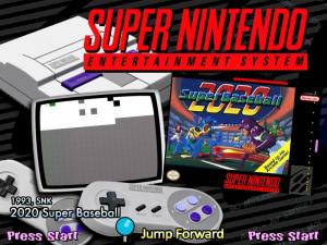

Gojoe Posted May 6, 2013 Posted May 6, 2013 I hope I am posting this to the right place... I read around and did not find an answer. Pretty much I am trying my hardest to get this Hyper Sync to work. I can download all the videos fine (in mp4 format) however, when Hyper Spin tries to display the videos they are all scrambled. See the below photo: I believe I am using all the up to date files (uninstalled everything, then re-installed using all of the current downloads available on the main site. Should these videos be flv format? I converted a few to flv format but they still would not work. Am I doing something wrong? Thanks for helping this noob.
fudgeyall Posted May 6, 2013 Posted May 6, 2013 I'm pretty sure this is an issue with intel 4000/2500 graphics (that hasn't been resolved). Someone correct me if I'm wrong, but the only way to fix it is to convert the videos to .flv
synakcm Posted May 6, 2013 Posted May 6, 2013 I'm pretty sure this is an issue with intel 4000/2500 graphics (that hasn't been resolved). Someone correct me if I'm wrong, but the only way to fix it is to convert the videos to .flv Or spend $25 on a video card on newegg.com

WEB11 Posted September 2, 2013 Posted September 2, 2013 Same issue here. I'm using an i5 processor with integrated graphics.
smorg Posted September 2, 2013 Posted September 2, 2013 I have the same issue. There is no fix. The best option is to replace the videos with PNG images of a game. Make sure to remove the videos from the folder but to give the images the same name and resolution as the videos.
ssshake Posted February 5, 2015 Posted February 5, 2015 I have the same issue.There is no fix. The best option is to replace the videos with PNG images of a game. Make sure to remove the videos from the folder but to give the images the same name and resolution as the videos. Disappointing to hear that after two years there is still no fix from the hyperspin devs. My friend just built an arcade machine with a very competent mini-atx system. But has no pcie ports for a video card. I think it's kind of unreasonable to pass the responsibility onto the end user.
ssshake Posted February 6, 2015 Posted February 6, 2015 Disappointing to hear that after two years there is still no fix from the hyperspin devs. My friend just built an arcade machine with a very competent mini-atx system. But has no pcie ports for a video card. I think it's kind of unreasonable to pass the responsibility onto the end user. I found the solution in my case in this thread: http://forum.arcadecontrols.com/index.php?topic=139953.0 Basically go into IE, install flash player if not already installed, pull up a flash app (like youtube). Right click, pull up settings, uncheck hardware acceleration.

Snesfan Posted March 4, 2015 Posted March 4, 2015 I found the solution in my case in this thread: http://forum.arcadecontrols.com/index.php?topic=139953.0Basically go into IE, install flash player if not already installed, pull up a flash app (like youtube). Right click, pull up settings, uncheck hardware acceleration. That worked for me, thank you
relic Posted March 5, 2015 Posted March 5, 2015 http://www.hyperspin-fe.com/forum/showthread.php?39284-fuzzy-effect-on-my-videos-even-so-there-mp4-format heres what i did and it worked like a charm 100%
andlat Posted May 27, 2015 Posted May 27, 2015 I found the solution in my case in this thread: http://forum.arcadecontrols.com/index.php?topic=139953.0 Basically go into IE, install flash player if not already installed, pull up a flash app (like youtube). Right click, pull up settings, uncheck hardware acceleration. Old thread, but I just wanted to chime in that I had this issue too. Disabling hardware acceleration worked everything out for me!
Retro Goonie Posted May 27, 2015 Posted May 27, 2015 Just want to second what others have said! I had the same problem but followed the "disable hardware acceleration" process and now everything works fine! My Artwork! Carts: GCE Vectrex 2D Carts (Realistic Version) 1.0, GCE Vectrex 2D Carts (Vector Version) 1.0 Pointers: NEC PC Engine Pointer(s), NEC SuperGrafx Pointer(s), Sega SG-1000 Pointer(s), Sega TecToy Pointer(s), Sega Mega Drive Japan Pointer(s), Nintendo 64 Pointer(s)
snarfo Posted May 28, 2015 Posted May 28, 2015 It's also fixed in the 1.4 beta. Joystick input is also working among many other things. HTPC: Gigabyte BRIX Pro w/Intel Iris Pro graphics, Windows 8.1 x64/8gb RAM
