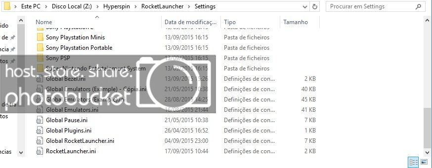

goldguitarguy Posted September 14, 2015 Posted September 14, 2015 Judging by the directory that RLauncher is looking in for an emulator for that system,it means you have not reset up your emulators after the update...go into RLauncherUI and set the paths to your global emulators
o0bigbossuk0o Posted September 15, 2015 Posted September 15, 2015 Ok so I'm kind of in the same situation. My 4TB hard drive was pre configured and now I have updated to 1.4 I have the same message when I try to launch a game? Is it a case of telling RocketLauncher where to find the emulators or do I have to install retroarch?

SIMPLYAUSTIN Posted September 17, 2015 Posted September 17, 2015 Hang on.. let me look EDIT: No no no.. mate... go into Z:/RocketLauncher/Settings folder and look for it there Something like Emulators (example).ini Simply Austin's YouTube
SIMPLYAUSTIN Posted September 17, 2015 Posted September 17, 2015 Rename Global Emulators.ini to something dif (BACKUP) more than likely. then take away the (Example) text from the one above so that then becomes the Global Emulators.ini file... then try Simply Austin's YouTube
