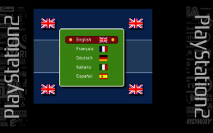

demonseed Posted September 17, 2015 Author Posted September 17, 2015 Hey So I download the one below.. works great.. however I still have a larger than desired border below the emulator screen and above. I am not sure what the issue is. I tried setting the first two too zero but it loses the bezel on one side or makes the screen off centre and smaller? I just checked and my screen here is 1440x900.. could that be the issue? I have confirmed the bezel works. but trying to maximize screen. I thought this would be easier. I tried changing the bottom two numbers too 1440 and 900 but the emulator is still small. I am wondering if it is a setting? I checked PCSX2 and I had it at 640x something, so I changed it to 1440x900 but still does same thing. I also noticed that there the bezel is not taking up full screen. I am finalizing my testing on this PC then going back to my TV.. which could change everything. http://imgur.com/WKM8ABI [General] Bezel Screen Top Left X Coordinate=240 Bezel Screen Top Left Y Coordinate=0 Bezel Screen Bottom Right X Coordinate=1680 Bezel Screen Bottom Right Y Coordinate=1080
demonseed Posted September 17, 2015 Author Posted September 17, 2015 WHen I turn them off , my ps2 looks fine.. leaves about inch on either side but is full 4:3 screen. Ok So I resized a black background to 1440x900. it works now BUT when I exit PCSX2 still flashes the window.. before exiting.. Errr.. when I used defaults... it did not do that. I thought the bezels would hide that window on exit
