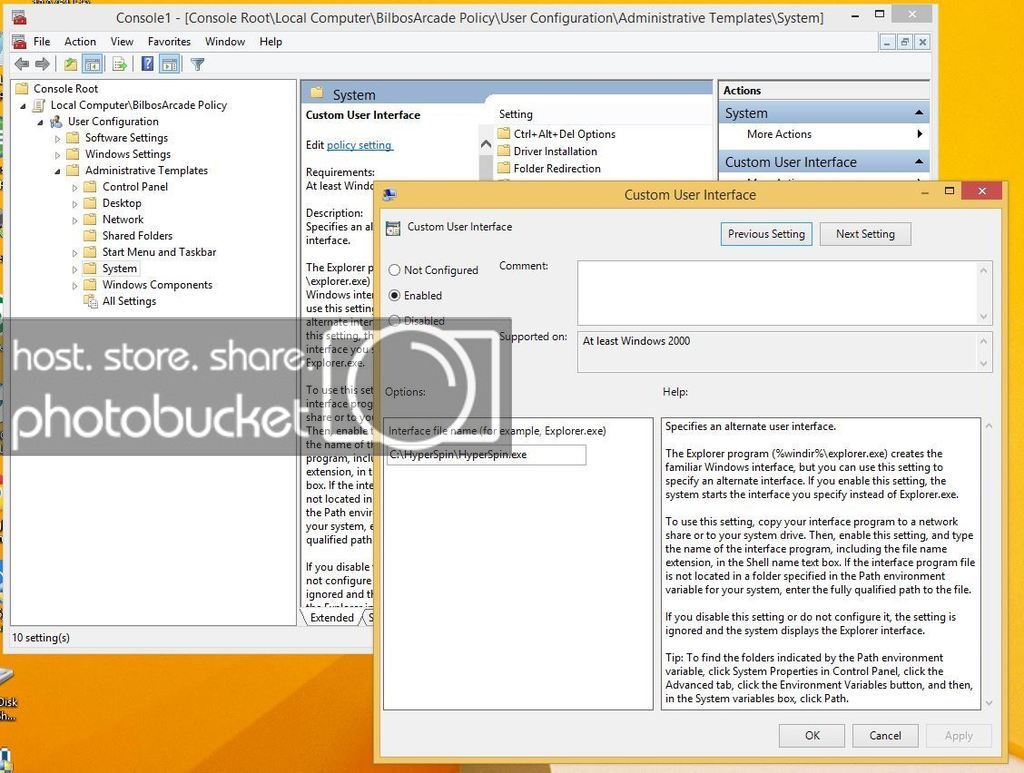

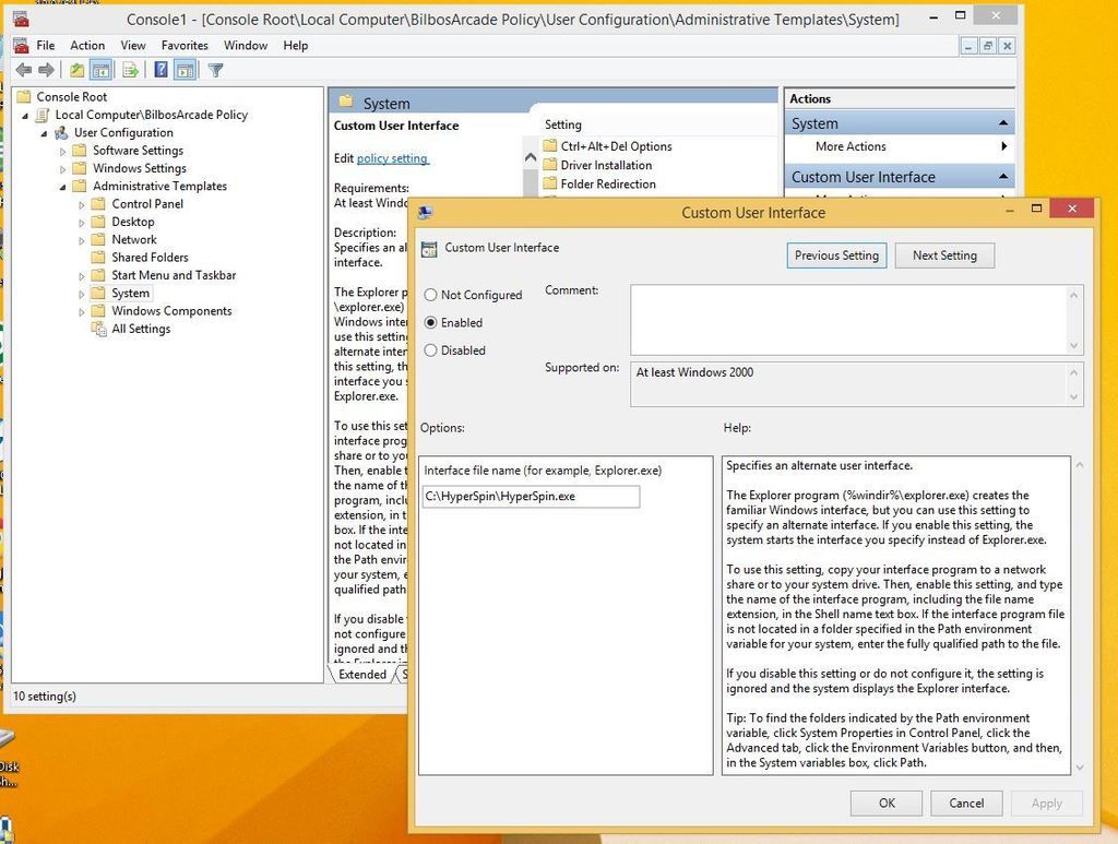

So here goes:
To use group policy to set the Windows shell, i.e. have a different program load instead of explorer.exe you must have the pro version of Windows or above.  This includes 7, 8, 10.
1) Open Local Group Policy Editor
2) Under 'User Configuration' on the left, select 'Administrative Templates' then 'System.
3) On the right hand pane, you should now see the group policy, 'Custom User Interface'.  Double click this policy to open a new window.
4) On the new window, make sure to enable the policy using the radio buttons.  Also make sure to include the full path to the HS exe file.  For example - 'C:\HyperSpin\HyperSpin.exe'
5) Click 'OK', then restart.  Upon restart Windows will load HyperSpin.exe (or any other exe or script) rather than explorer.exe.

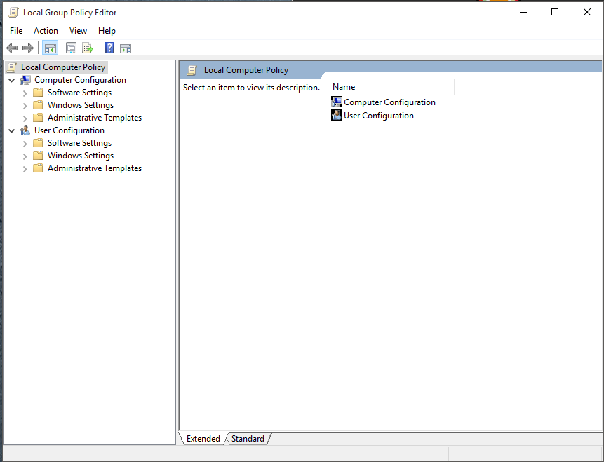

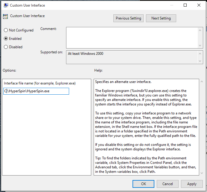

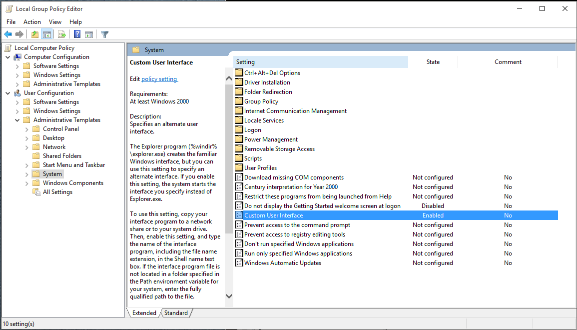

I have done EXACTLY that on my Windows 8.1 pro, but this still boots to the desktop and then loads Hypersin. What am I doing wrong?
Have you enabled the policy and do you have the full path to HyperSpin in the box?
Post a screenshot of the group policy screen
Hope that works
Everything is correct there. You must be applying it to a group policy that isn't being applied.
Make sure you're following the instructions and are going to the 'Local Group Policy' editor.
Why does it start Hyperspin automatically after launching the desktop though, if it's not the group policy that's doing it?
Because it isn't using the group policy. Do you have a shortcut to HyperSpin in the startup folder in the start menu?
