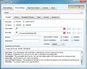

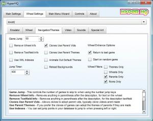

Reefboi16 Posted September 20, 2015 Posted September 20, 2015 So I have all my MAME emulator configured. I am able to launch all my roms from rocketlauncher so they all work. They even work in hyperspin but my problem is I set the parent and roms only filter on the MAME wheel and now MAME will not launch. Specifically I believe the "rom only" filter is causing it. I applied one at a time and it only fails to enter past the main MAME menu. I looked at my extension and saw somewhere that extensions where case sensitive and even thought my files are zip I went ahead and added "ZIP" in the extensions without luck. Any body have any idea what I can do. I played with settings for hours and finally just decided to post and ask for some help. Thanks in advanced.
Reefboi16 Posted September 20, 2015 Author Posted September 20, 2015 Hmm I will make sure to double check. But what you described is correct, it only does this when I select the "rom only" filter. It is actually doing it to almost every system now that I notice. I was attempting to filter out the roms I do not have and for the roms to use parent roms under Hyper HQ. I am able to select the Parent rom filter just fine the problem is when I choose "rom only" it kicks me back like you stated.
Reefboi16 Posted September 20, 2015 Author Posted September 20, 2015 I don't see how the rom path is incorrect if I am telling you I am able to get into the system and then play the room if i don't set any filters.
Reefboi16 Posted September 20, 2015 Author Posted September 20, 2015 I was attempting to filter out the roms I do not have but it filters everything out regardless.
Reefboi16 Posted September 20, 2015 Author Posted September 20, 2015 I have set rom paths in both hyper hq and rlauncher. For every system.
Reefboi16 Posted September 20, 2015 Author Posted September 20, 2015 I have rom path set and exucatble set on hq, executable is pointing to rlaunche.exe not the UI off course.
Reefboi16 Posted September 20, 2015 Author Posted September 20, 2015 I only did that in an attempt to see if that is why i was unable to filter. I will remove it thank you, still doesn't fix the filtering issue.
Reefboi16 Posted September 20, 2015 Author Posted September 20, 2015 aaaahh there you go, I knew it had to be something simple after staring at the screen for 2 hours. Because I set them on the emulator I figured it was redundant to do them here. Its what you were explaining earlier but now it makes sense. WOW I feel dumb lolI appreciate your help man.
Reefboi16 Posted September 20, 2015 Author Posted September 20, 2015 I will make a note of that. Typed in my extensions and it is good to go. Great again thanks.
