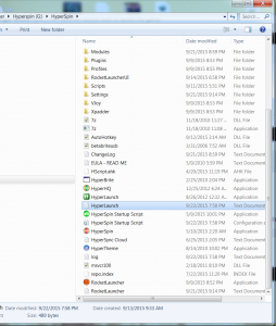

The issue is I'm trying to use the latest version of RocketLauncher to launch the games but it keeps trying to use Hyperlaunch.  Do I need to take Hyperlaunch out of the folder structure?
Keys are mapped per Gutchs script and that works fine except when trying to launch a game.  Then it doesnt even try to launch.
 I have also attached the folder structure.
I am using both the latest vesions of HyperSpin and RocketLauncher.
