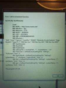

doyoudesign Posted October 3, 2015 Posted October 3, 2015 I loaded Hyperspin onto a new computer and it's giving me a hard time. I finally got all the roms to work with in Rocket launcher and all the roms are good and when you launch it with in RL it opens up and it runs great. When i open HyperLaunch the graphics and videos play but when i select any mame rom it comes up with an Error: CAll to nonexisten fucntion. I've attached the error message...any help with this?

doyoudesign Posted October 3, 2015 Author Posted October 3, 2015 I took me about a month to get Hyper spin and Rocketlauncher to work at the beginning of the summer. I picked up another laptop and wanted to install it on the new computer too. VERY afraid to update anything as everything works fine. I took the entire folder containing HyperLaunch, HyperSpin, RocketLauncher and Roms that was working great on one computer and copied it directly to another computer. HyperSpin Version 1.3.2.0; RocketLauncherUI Version 1.0.0.1; HyperLaunch Version 1.1.7.3 I followed the set up instructions and have most everthing working again with the correct pathways to all the files. In Rocketlauncher everything loads and launches from Rocketlauncher into Mame. Mame works from the actual Mame program into the roms fine. In HyperSpin, all the wheels work and load into the videos. The only thing that does not work is the link between HyperSpin to launch Mame into the Rom. And the error message that I photoed above is given and I can't figure out how to fix it. Any advice?
gigapig Posted October 3, 2015 Posted October 3, 2015 All previous advice with errors like that is to make sure it's up to date. Once done it will be kept up to date automatically. If anything goes wrong you can always transfer it again.
doyoudesign Posted October 3, 2015 Author Posted October 3, 2015 Ok...updated all the programs... Now everything in RL works as before and opens up ROMs in MAME. When in HyperSpin it begins to open MAME but then gives the error: Cannot find C:\HyperSpin\Databases\MAME\MAME.xml any advice?
doyoudesign Posted October 3, 2015 Author Posted October 3, 2015 Actually i know what the problem is... How do I find the setting where I can change the above error? Is it in RL or HL?

doyoudesign Posted October 3, 2015 Author Posted October 3, 2015 My Data base file moved to the new computer into a different directory path. How do I reset the path where Hyperspin access the database/mame/mame.xml?
gigapig Posted October 3, 2015 Posted October 3, 2015 I don't think you can, you'll need to rename your HyperSpin folder to just "HyperSpin"
doyoudesign Posted October 3, 2015 Author Posted October 3, 2015 fixed it!!!! just renamed the file to Hyperspin and it worked
