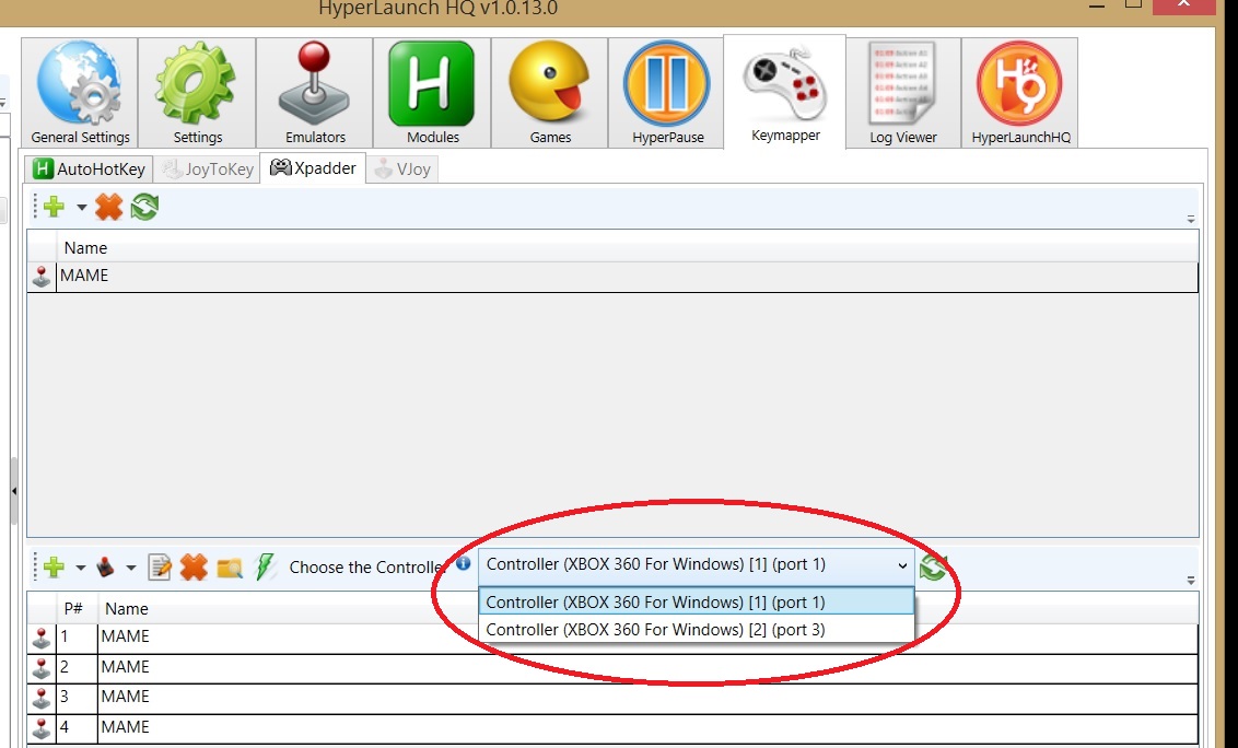

Hoping to get help with what would seem like a simple problem. I have an arcade cabinet. The controller in Player 1 position (left side of cabinet), is detected as "Controller (XBOX for Windows) [2] Port 3" in Hyperlaunch. (see pic). Is there a way to edit the Port each controller is assigned to? I want to change Player 1 to Port 1, Player 2 to Port 2, etc. This would be the best solution for my setup.

Ok i got this resolved and my setup is FINALLY PERFECT! I should make a thread about this when I have time since I know this affects a lot of people (even outside of hyperspin use). It is not a hyperlaunch/hyperspin problem, it is a windows problem. Solving it basically came down to completely uninstalling all gaming controllers and then reconnecting in order. But its not as easy as opening device manager and then uninstalling. You have to make sure that even the registry values are removed which required help from a 3rd party program called 'Device Remover'. Otherwise the system will remember the Ports as soon as you reconnect your controller again. Here are my notes on how to get it fully fixed...
