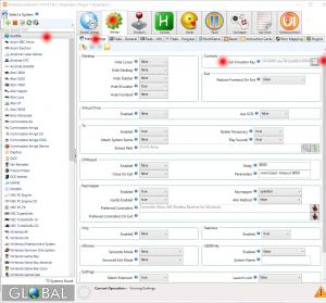

JayC Posted November 28, 2015 Posted November 28, 2015 He means they have "nothing" to do with the emulator controls. You have to change the exit key for rocket launcher or hyperlaunch (depending on which you use) I believe.

gigapig Posted November 28, 2015 Posted November 28, 2015 In RLUI you can set an exit emulator key either globally or if your set up is up to date then on a per system basis. This can be a keyboard key or keys or a button combo, whatever you like. It is not recommended you use esc as some emulators use that to switch between windowed and full screen. HyperSpin 1.4 should have fixed the wheel moving erratically, if you don't want to use that then do as the other guys have suggested and use a keymapper.
