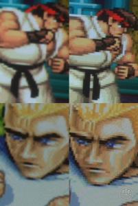

j2chulo Posted December 8, 2015 Posted December 8, 2015 Hello community. Let me introduce myself I'm Jay and I am kind of new to hyperspin. I had used mame for years now, on and off. I recently decide to build a nice retro game machine. I am not going to go into detail about CP specs. My problem is when I launch a game straight from mame games video resolution look good but when I launch the game through hyperspin they video game its showing in pixels. For example SF2 Ryu face its made out of pixels. I mean you can see it while when I launch same game through mame Ryu face look like and smooth. I am running hyperspin 1.4 and mame_Plus_Ash_Build_64_0.168. I appreciate any help. thanks Picture on the right side it's fine, Left pic showing pixels
gigapig Posted December 8, 2015 Posted December 8, 2015 Hi Jay and welcome. Mame may have some Bilinear filtering set but it is not switched on in RLUI under Edit Global Model Settings. Have a look there.
j2chulo Posted December 9, 2015 Author Posted December 9, 2015 Hi Jay and welcome. Mame may have some Bilinear filtering set but it is not switched on in RLUI under Edit Global Model Settings. Have a look there. Thank you for your quick reply gigapig. I just finished looking through RLUI setting on global setting and mame setting. I cannot find the problem. I did noted that screen resolution on Multigame General option for base with its at 1920 and eight 1080 but I am assuming that is the resolution for hypersping not for the game.

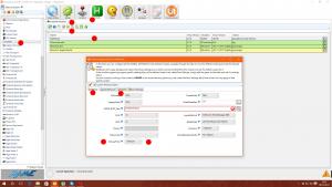

j2chulo Posted December 9, 2015 Author Posted December 9, 2015 sorry I am really a noob when it come to hyperspin. I am looking at RLUI trying to find the bilinear filter under Edit Global Model Settings. but I can not find it. can somebody guide me step by step where is the bilinear filter. or post a pictures on where is the setting located. thank
gigapig Posted December 9, 2015 Posted December 9, 2015 Check it under both Settings and Mame. It's most likely set to default.
j2chulo Posted December 10, 2015 Author Posted December 10, 2015 Gigapig thank you so much that did it. My setting was set to default I changed it to True and it fixed the pixels problem with my games. I see there are few other option there like bezels GLSL, HLSL, Cheatmode etc on this setting menu, I will like to find out more and see what I can change on hyperspin. but I guest this is something I will figured out slow. Its there a Manual for hyperspin that kind of explain some of this setting. Thanks again for your help.
