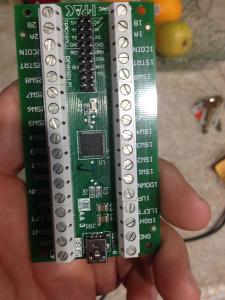

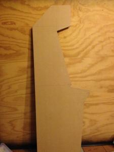

josefino Posted December 31, 2015 Author Posted December 31, 2015 Believe it or not, I thought about taking a machine home, but don't want to come on the news. Its more rewarding to build my own. I know I have a long way to go, but for now I keep working in the arcade place. So I reimaged my computer and at this moment its downloading roms. So sides are done Computer has been reimaged, Hyperspin has been downloaded hyperlauncher has been doloaded Ipac board has arrived joystiks and buttons have arrived board where buttons are going to be placed is complete, I think Edges on side boards have been smooth out I will try to post my progress as it comes along Luckily my father in-law is master carpenter and he is giving me advice

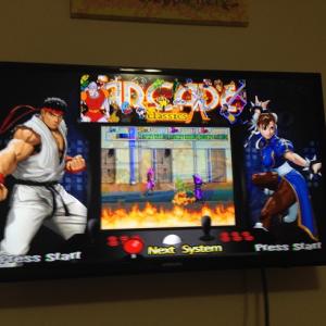

josefino Posted January 5, 2016 Author Posted January 5, 2016 So finally I got HyperSpin and RocketLauncher working together, its a pain, but its rewarding when I was able to get them working in harmony. Then I got some roms and that was another dilemma, I downloaded MAME 0.169 but when I launch it I got a bunch of errors, such mame.ini was not found and other errors that I don't recall. Then after searching in this forum, don't recall the name, but that person was king enough to post MAME 0169 with the required files and it was modified with no nag, high score and other stuff. Finally at 2 AM was able to open MAME 0.169 and told where roms where located and viola roms loaded with no issues and I was able to launch it from HyperLaunch. For me it was relief since I been working on this for a month now, family and holidays did not let me dedicate much time. I really feel accomplish, hopefully today I would be able to get the rest of the wood I need to get the cabinet at least standing. I would like to thank the folks that keep this site running, people that post issues and resolutions, but specially SimpleAustin. If it wasn't for his videos I will be stuck, anyways thanks for all the help. Next loading NES and SNES I will post my progress soon

josefino Posted January 7, 2016 Author Posted January 7, 2016 Hello guys, well I have made some progress, not as I wanted but slowly it moving forward. I been messing MAME, finally it loads fine and roms load properly, I got joysticks and buttons installed. When I was ready to start wiring, I misplaced the terminals, dam I was so mad. But well, now I need to buy another pack of terminals, hopefully do the wiring this coming weekend. So my plans for the weekend are to pick up the fiber wood to complete the cabinet, purchase the terminals for the buttons and joysticks (Fry's is too far from my house), pickup the cable I purchased HDMI to DVI, try to finish all the wood work; hopefully mount the 32" tv. Probably I'm getting ahead of myself, but that's my goal. Unfortunately I work at the milf place Thursday's and Friday's so I wont have much time to finish installing retroarch. I installed RetroArch but I got the dll error. Does anyone have the link to download DirectX 9? Well guys that all for now, I will post my progress later

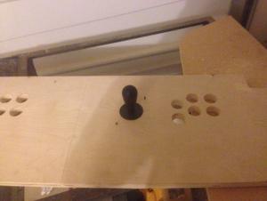

josefino Posted January 12, 2016 Author Posted January 12, 2016 Hey guys, well some progress has be done. I was able to cut the remainder of the wood needed for the cabinet. 45 angles are not easy, but not impossible. Got the wiring for the buttons and joysticks done, not working properly, but I know where I messed up. NES roms have been loaded with retroarch, but sound is bad when I launch a game. After reading some post I found out I need to disable vsync in retroarch and make sure drivers for sound card are updated, so that's planned for tonight. So slowly is moving along, do any of you know someone that can print graphics or have the files so I can take them somewhere to be printed? let me know the price so I can start saving up, I hope by this weekend have the cabinet assembled. The more I get into this site and project, the more I love it, soon I will become platinum. Thanks guys for all the information

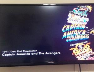

josefino Posted January 14, 2016 Author Posted January 14, 2016 Finally I feel a made progress. So I kept having issues with RetoArch as far as chopi sound, tried many configurations such turning off vsync and shudders. Watched SimpleAustin videos over and over and read all 600+ comments on videos and same thing. I read and read RetroArch forums and same issue, i even reimaged my computer since I changed many configurations and modified my roms. I really was to the point of trashing my computer. After taking a day off from HyperSpin I came across RetroArch 1.2.2 and finally I saw the light, after running RetroArch 1.2.2 and updating it, I opened NES rom and viola, it worked with no issues. Then I had to copy the files SimpleAustin provided on video tutorial and bezels and media loaded with no issues. So once again I fixed my own issue with the help of SimpleAustin videos and HyperSpin forums. Then I proceeded to continue working on the pending wood items, still needs work but at least cabinet is standing. Many thanks to the people that take the time to assist noobs like me
