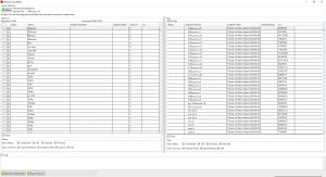

PXAbstraction Posted January 19, 2016 Posted January 19, 2016 So I gave Don's Renamer a go but I'm not sure if I'm using it right. I don't see an option I can specify to copy the correct ROMs to another folder like you mentioned. It also asks me to specify a naming convention but as I'm trying to run this against a MAME ROM folder, none of the conventions in his pulldown are applicable and I'm not sure what I should specify. When it completed, it said there was about 7,600 mismatches out of over 10,000 ROMs but the two columns didn't look at all similar so I'm not sure how to match them up from there. I'm obviously missing some key steps here. Parallax Abstraction Ottawa, Ontario, Canada Blog | YouTube | Twitter

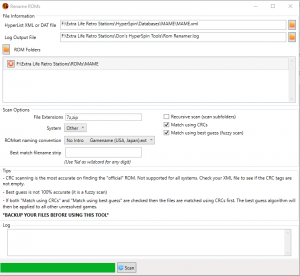

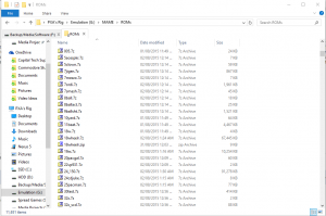

PXAbstraction Posted January 20, 2016 Posted January 20, 2016 Forgive me for sounding like an idiot here. So I am trying to clean out a MAME set. I have a complete set of ROMs for the latest release of MAME (0.169 at time of writing.) I have HyperSpin set to only use parent ROMs (I'm also using a database in RocketLauncher that only recognisees the parent ROMs) but ideally, what I'd like to do is delete all those unnecessary child and clone ROMs to clear up space as these retro stations I'm putting together will be running on old laptops with limited storage (we're talking a 64GB SSD in one case here and that also has to hold Windows.) So I loaded up Don's HyperSpin Tools (the renamer), pointed it at my RocketLauncher database and then the path that contains the MAME ROMs. See the first attached screenshot. I'm not sure how I should set the ROMset Naming Convention because this set uses what I think is just the standard MAME naming convention. See second attachment. After a very long scan (the better part of an hour), I'm presented with what you see in the third attachment. This is where I'm unsure where to go from. The two lists obviously look quite different and I'm not sure if those results are normal and are going to produce what I hope they will (i.e. getting rid of all the child and clone ROMs from the folder.) I also don't see an option in here to move mismatched ROMs to another folder which I believe was the stated intent of using this tool. I'm sure this is just me not understanding how to properly configure this and it's probably one of those things that once I'm done it a single time, I'll get it going forward. Does this make any sense? Thanks! Parallax Abstraction Ottawa, Ontario, Canada Blog | YouTube | Twitter

PXAbstraction Posted January 20, 2016 Posted January 20, 2016 So I just did a little bit of preliminary searching and it looks like there's going to be no easy way for me to do this because I'm using a merged ROM set. Basically, all the child and clone ROMs are in 7z containers with the parent ROMs so there's no real way to separate them out. I could download the unmerged set but the main purpose of the merged set is to save disk space so even if I grabbed an unmerged set and pruned out all the unneeded ROMs, the end size would still be similar to what it is now. Ah well, at least now I know. Thanks for the help! Parallax Abstraction Ottawa, Ontario, Canada Blog | YouTube | Twitter
Nocturnaloner Posted January 20, 2016 Posted January 20, 2016 Here's a question: Does Don's Renamer work with merged rom sets? Each game consists of many files. What I see in that spreadsheet layout is that it seems to be looking at one component of a rom, and making it equivalent to the whole game, which it is not. Oops! Simulpost. I see we had the same idea. Looks like if you want to do this, start with the split rom sets. I know the newest tutorials online for Hyperspin say to start with merged, but for more options, split is the way to go.
