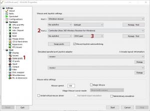

gigapig Posted February 7, 2016 Posted February 7, 2016 Sure. Can you rest chuck rock? In the console version of the game you should be able to jump and belly bump with two separate buttons where this I can barely belly bump. I can also look up the other game I was trying and I couldn't press the start button to begin the game. I tried all the buttons and it wouldn't start, it was a platformer. Something has to be wonky here Well done Ninjy, you were correct and that made me figure it out, although I don't know why my original mappings didn't work. See screen below also. Switch on your gamepad. Start WinUAE. Load your CD32 host config file. Go to game ports on the left. Under Port 2 select the gamepad you are using. Just under Port 2 you will see "Default" you need to change that to CD32 pad which will give you the correct mappings for CD32 and Chuck Rocks Belly Bounce. Unga bunga. Remember to go back to the config tab and save your config.

ninja2bceen Posted February 8, 2016 Author Posted February 8, 2016 Works now, thanks giga Sent from my iPad using Tapatalk Advance the cause to 100%. http://hyperbase.hyperspin-fe.com/ Planet Geekdom, Subscribe for Tutorials! https://www.youtube.com/channel/UCdcby-s2GwriaOHGmVC2vGA?sub_confirmation=1&app=desktop
