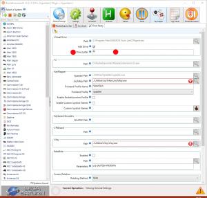

If you haven't done already you may need to set the letter that your DT drive is using. You can find that out by mounting an image.
The guys have given you some great advice and you should be nearly there, the drive number thing usually causes the black screen issue. Don't forget it could be 0, 1, 2, 3, or even 4.
post-2819-0-30250000-1455824728_thumb.jp
Wait so i can actually go into DTLite and click on my drives and see what number they are slotted in to confirm what number to put in there instead of guess and check? Whats the pathing on that? like do i go into where my DTLite is like for example C/Program Files/DTLite? or is this a different location usually?
You can do it that way or you can just single click the DTLite icon in your system icons tray at the right of the taskbar. Nomenclature is [sCSI - #] or [DT - #] where # is the drive number you'll want to see in your SSF.ini file.
Some people need this parameter left blank. Not sure why but it's the only way it'll work for some people so if, after you get it working outside of HyperSpin, you get the CD screen through RocketLauncher, first set CDDRIVE in RLUI to your DTLite drive number. If that doesn't work, try leaving it blank. I'm one of those people who needs it left blank.
