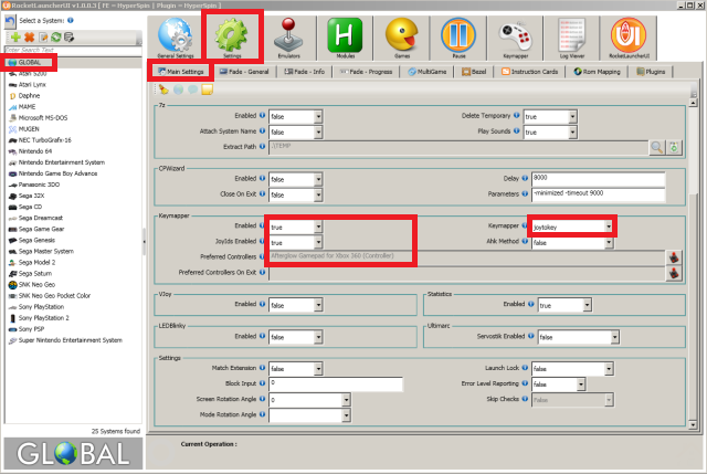

Spawk Posted February 19, 2016 Posted February 19, 2016 Please have a look at my tutorial. These are the three profiles you should have under global: Hyperspin RocketLauncher _Default Hyperspin is set as the default and active profile. RocketLauncher gives you controls while in hyperpause and _Default allows switching of profiles (probably why profile1 is still loaded). Sent from my SGH-I337M using Tapatalk

Mydriaze Posted February 22, 2016 Posted February 22, 2016 Please have a look at my tutorial. These are the three profiles you should have under global: Hyperspin RocketLauncher _Default Hyperspin is set as the default and active profile. RocketLauncher gives you controls while in hyperpause and _Default allows switching of profiles (probably why profile1 is still loaded). Sent from my SGH-I337M using Tapatalk Hello spawk, great JoyToKey tutorial, but I'm still a bit lost. I can't find the keymapper area in the main settings tab: it seems now it's under the "mapping" tab. Hyperspin is set as the default and active profile. RocketLauncher gives you controls while in hyperpause and _Default allows switching of profiles (probably why profile1 is still loaded). So, if I don't need Hyperpause, it's not mandatory to create a RocketLauncher profile? Excuse my English, i'm French. Razer Atrox Porn Pics
Spawk Posted February 22, 2016 Posted February 22, 2016 Hello spawk, great JoyToKey tutorial, but I'm still a bit lost. I can't find the keymapper area in the main settings tab: it seems now it's under the "mapping" tab. So, if I don't need Hyperpause, it's not mandatory to create a RocketLauncher profile? I didn't notice anything changing in RL. I am at work so can't check atm.Keymappers are referenced in all three sections: general settings, settings, and keymapper tabs at the top. You dont have to create the RL profile if you are sure you will not use it... but creating it only takes 2 seconds and you won't have any adverse effects from doing so. Sent from my SGH-I337M using Tapatalk
