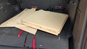

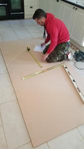

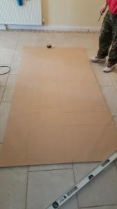

So now was the time to build the cabinet, I opted for a bartop one instead of a full height for the first build

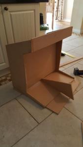

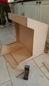

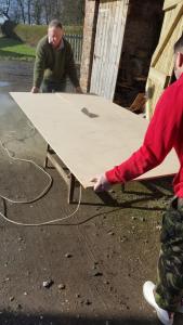

Well bit the bullet today and started my first build.
I a total DIY biff so keep this in mind and also why my brother in helping out!

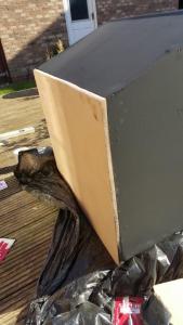

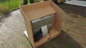

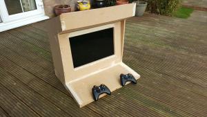

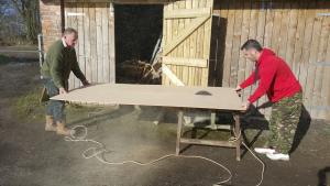

Well from a piece of wood to a "sort of cabinet" took about 3 hrs.

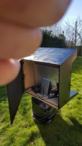

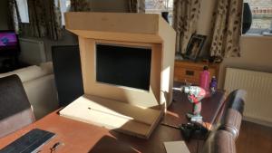

I have cheated a little as I had an ALL IN ONE pc sat on my study floor for the past 4 months and figured it would do.
I have used 360 style controllers for this build as I have PS2 etc on it and I need the shoulder buttons. I'm reserving the joysticks and buttons for the full height cabinet that I'm planning next.

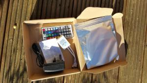

We are up to the built, filler in, PC in and all set up, controllers in. Just needs sanding, painting and decals putting on. Also opted for a 5M strip of multi coloured neon LED tape to go around the whole edges rather than plastic runners etc, when you see the decals you'll see why I'll be keeping them neon blue.
I'll update the post as I finish it off.

Man hours so far = 3 (+ 1 hr drawing plans out prior to build)

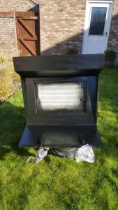

Update on the build.

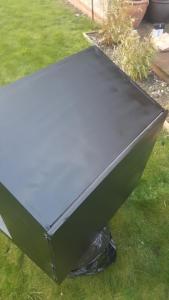

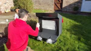

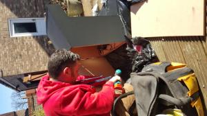

Cabinet build finished, painted, hinged rear attached, spray painted.
LED surround added, nearly there just waiting for the decals to arrive.
Added expenses
£14 primer paint
£7 Spraypaint
£9 LED lights
£4 hinges
£5 decals
Total for build £61
Time spent about 2 hrs

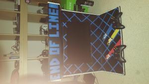

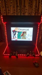

Possible red decal option, I'm looking at a nice TRON one also as the LEDs can change to whatever colour and I'm old and like TRON lol
Excuse the amazing artwork graphics are not my strong suit as you can tell

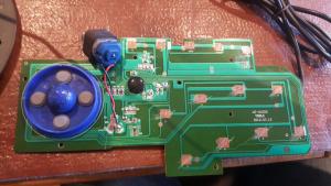

Well I am taking the plunge and gong sticks and keys over 360 controller.
So i have found these
http://www.ebay.co.uk/itm/261902469498?_trksid=p2057872.m2749.l2649&ssPageName=STRK%3AMEBIDX%3AIT
They work perfectly with minimal set up and USB in so no need for 100's of wires etc
Stripped down they look like this (see attached image) piece of cake to mount to your cabinet and paint any colour you like!
Just though I would share this with people in an attempt to save time and money as they are cheap and USB in!

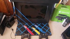

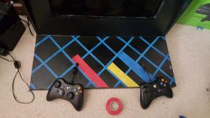

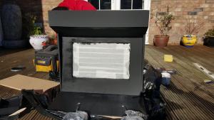

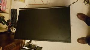

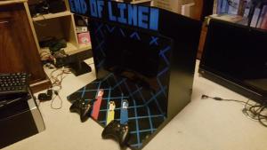

Well did the Vinyl wrap today and added some home made decals added.
Only annoying bit it I took the LEDs off to do the wrap and snapped the cable about halfway round ( another set ordered £9 added on to the build total!)
So today's costs were
Black roll of Vinyl - £4
Electricians Tape ( Red/ Blue/Yellow) £0.69p each
1 sheet of A4 for light Cycle prints £0.01p
Time spent on decals and wrap 1 hr
Total Cost of Build
£65.70p
Total Time spent on build
7 hrs
Going to be an extra 30 mins to swap the LEDs over when they arrive and then I may add some defuser tube over the top but I'll see how I feel at the time

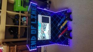

Well that pretty much concludes the Bartop on a Budget build ha ha
Ill add some completed pics once I've switched the LEDs over, I may paint over the "END OF LINE" also to thicken it up a bit

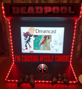

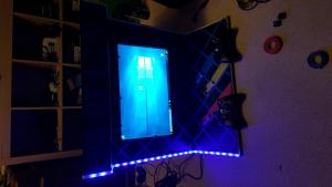

Cheers Rincewind the final thing is done.
LED's replaced and a few caots of satin varnish on the front to seal it and make it shiny
Excuse the mess  in the backgound it my "laboratoryas my kids call it
please keep in mind this was a quick build to see how cheaply it could be done

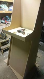

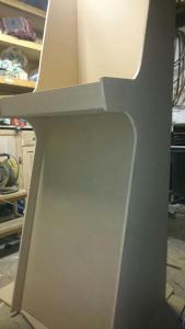

The next one a full size is so far shaping up a lot better as per the 2nd and third pics
