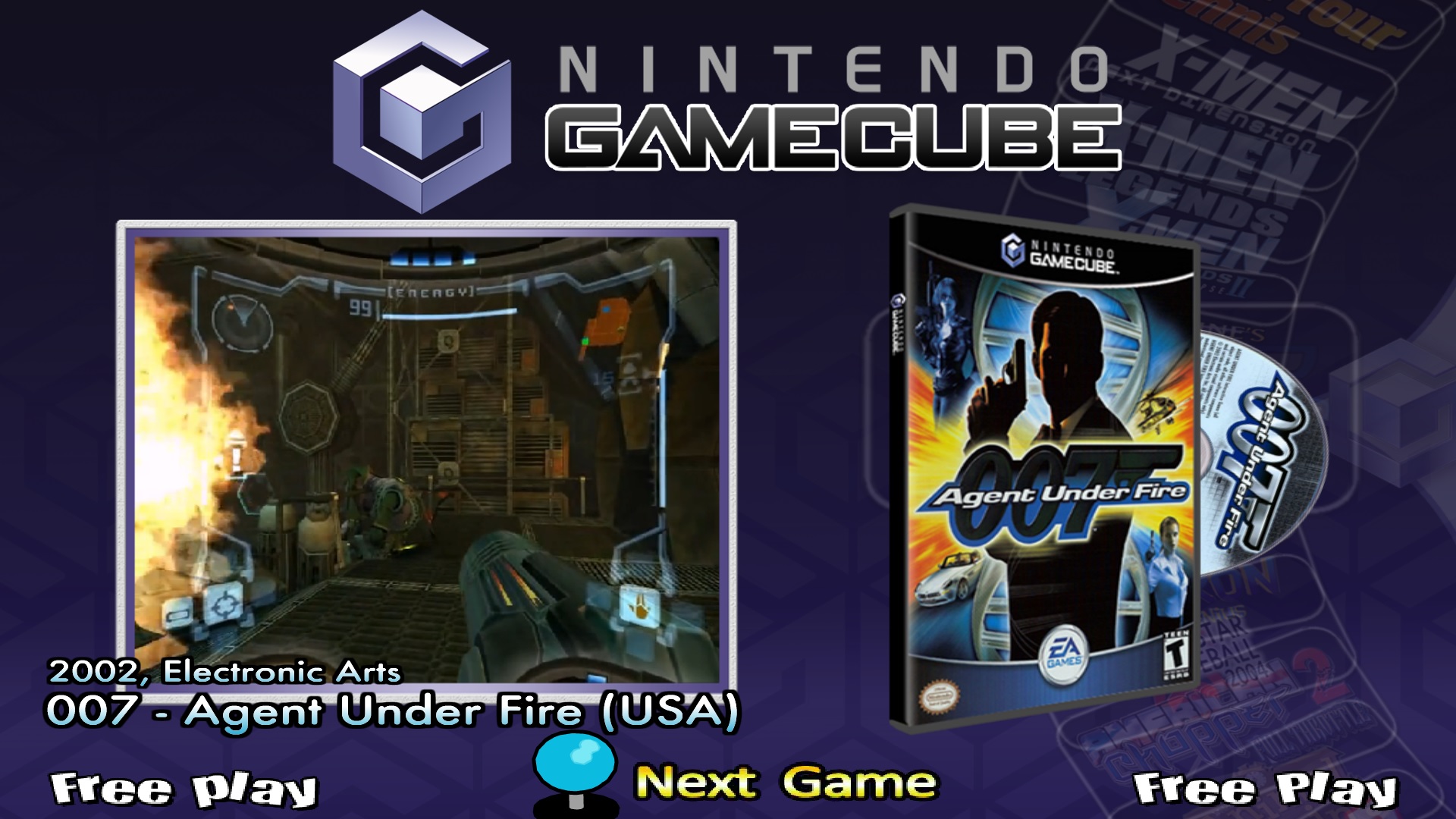

Hey guys,
How do you edit/manage system level themes (NOT for individual games, NOT for the main HyperSpin Menu, but rather for the menu just prior to picking the game). For example, GameCube has a Hyperspin wheel that flips through each box/cd art in some sort of default form - that theme is what I want to change. See image attached "sample" of what I want to customize.
I think it is located here, but HyperTheme (v1.1.5.0) fails to open it!    .\HyperSpin\Media\Nintendo GameCube\Themes\Default.zip
  "Error Parsing Zip"
Any suggestions or pointers to Themes for a newbie would be great.

Thanks for the reply. I tried to re-compress into a new ZIP file, but still get the same result. Hypertheme does open some other themes no problem, a handful of these themes don't work.
It seems that there are a ton of "game themes" as well as "system themes" but not the WHEEL themes like I show above. Or is this NOT a theme, but rather a "Wheel Setting/configuration"?
Sorry for sounding like a neo on this, but the whole concept of themes really has me confused.
  David
Now I understand what you're asking in regards to the different types of themes. What you are referring to is a System Default Theme, as opposed to a Main Menu Theme or Game Theme. Here is the location for the specific theme you're trying to work on. Try re-downloading it and let me know if works or doesn't work in HyperTheme for you. If you're still having issues with the freshly downloaded theme, we'll figure it out.
