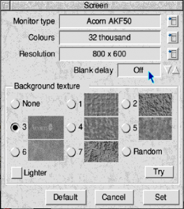

manson976 Posted May 28, 2016 Posted May 28, 2016 How have you guys got this setup from I'm reading you've over complicated it... You need 2 emulators Arculator & RPCEmu Arc is for the earlier games like lemming chuck rock etc RPC is for later games. Just Download a pre-formatted HDF drive loada floppyand drag the app into that drive inside a folder The Commands are simple for some more complex for others Examle.. Drive 5 Dir CHUCK !CHUCK or find the ADFS DIRECTORY more complex ie <CHUCK.$.!CHUCK.!RUN> Thats all for each game except for games like Fervour ie <GENERAL> <FAST> <PUZZLE> each one is a set of games but need !Fervour Parent on the BAR. Doom has no launch sadly looking into that it's launched with wad files associated with the doom launcher <DOOMU> <DOOMTNT> etc Resolution/Screen Size CAN only be changed with in the OS RPC is your best bet as that can reach 1024x768 at 32thosand colours. For this you will need the !BOOT file and set resolution. Good Luck Dudes

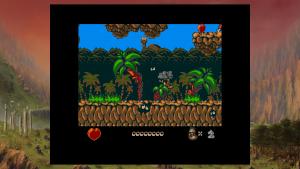

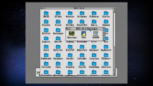

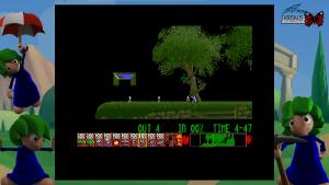

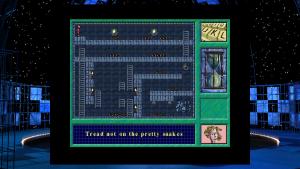

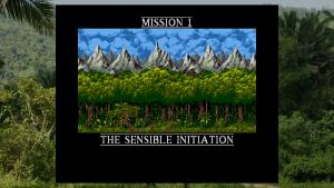

manson976 Posted May 30, 2016 Posted May 30, 2016 HERE YOU GO ARCADIANS FULLY SETUP Cannon Fodder Chuck Rock Crystal Maze Fervour James Pond Lemmings Many More... FEW THAT WAS FUN ARC FOREVER
vaderag Posted May 31, 2016 Author Posted May 31, 2016 On 5/30/2016 at 11:55 PM, manson976 said: HERE YOU GO ARCADIANS FULLY SETUP 20160530232612.jpg Cannon Fodder 20160530233609.jpg Chuck Rock 20160530235329.jpg Crystal Maze 20160530234143.jpg Fervour 20160530234705.jpg James Pond 20160531004433.jpg Lemmings Many More... FEW THAT WAS FUN ARC FOREVER I may have missed it above, but how on earth did you get bezels to work?? (And rid of the bar at the top??)Awesome work

manson976 Posted May 31, 2016 Posted May 31, 2016 Well I can you give a pack of bezels when I've finished the set right now i'm working on box art and wheels my other drive died so i'm re-doing box art. The way it works is just having a background as bezel and sizing window on top, using the window_class to hide the menu bar. You just have to set the resolution in the program itself.. 'There is no option for this in the settings for either emu'... Then just have all your games installed on your external hdfs Set all your cmd's in the setting files to launch each app (NOTE: some games need Basic or Wimp) Have a cup of coffee PLAY SOME WOLFENSTEIN 3D
