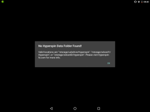

Sting Posted March 15, 2016 Posted March 15, 2016 I don't own a Shield handheld, but I have the Shield TV and a Nexus 9, and both come up with the message seen below if I don't have any files. Where did you get the Hyperspin apk and what version of Android are you running???

kllngtme Posted October 23, 2019 Posted October 23, 2019 On 3/15/2016 at 8:45 AM, Sting said: I don't own a Shield handheld, but I have the Shield TV and a Nexus 9, and both come up with the message seen below if I don't have any files. Where did you get the Hyperspin apk and what version of Android are you running??? Expand Is this still supposed to popup with the latest version of Android on ShieldTV and Hyperspin? Mines at 0.1.8. I installed fresh, changed the name of my directory to "Hyperspin_bak" as a test and I'm not getting a popup, it just seems to be crashing when I first try and load it.
