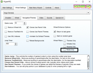

kylecp1979 Posted March 26, 2016 Posted March 26, 2016 do you havve roms only selected in hyperHQ? try turning that off if you do.
Feanor7777 Posted March 26, 2016 Author Posted March 26, 2016 do you havve roms only selected in hyperHQ? try turning that off if you do. I can't find that option in HyperHQ. Where is it? Also, should I populate the "Executable" and "Rom Path" in HyperHQ under the emulator tab for each wheel? If so, is executable something I should point towards RocketLauncher? For the record, I tried with that empty as well as pointing it to RL and Hyperspin.

Spawk Posted March 26, 2016 Posted March 26, 2016 No need to ever set the executable in hyperhq. Let RL handle all that. The rompath and extension set in here is just to populate the wheel when using the "roms only" option (found in the navagation tab). Sent from my SGH-I337M using Tapatalk

Spawk Posted March 26, 2016 Posted March 26, 2016 Roms only is on... so I will assume either the path or extension is wrong. If you use multiple extensions be sure to place a comma between them (no spaces!) Sent from my SGH-I337M using Tapatalk
Feanor7777 Posted March 26, 2016 Author Posted March 26, 2016 It worked after removing the roms only filter and setting the rompath and executable in HyperHQ. The last part is weird since I thought RL took care of that kind of thing, but it works so I'm happy enough. For some whacky reason the genesis background and top banner shows Turbographx instead of Genesis, but that must be only a matter of changing the art in the media folders. Thanks, guys!
