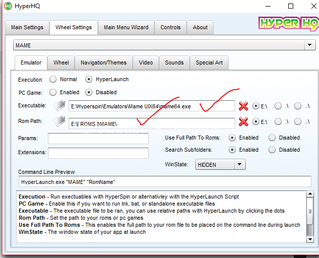

brash199 Posted April 3, 2016 Posted April 3, 2016 Sounds like you are missing a step in Hyperhq. When you set up the mame wheel did you add the extensions. 7z,zip,Chd,rar? Sent from my iPhone using Tapatalk
skpManiac Posted April 3, 2016 Author Posted April 3, 2016 Sounds like you are missing a step in Hyperhq. When you set up the mame wheel did you add the extensions. 7z,zip,Chd,rar? Sent from my iPhone using Tapatalk ok, NO I din't do that - I didnt even see it :/ So the format there is .zip|.7z or zip|7z without the dot? Thanks Sorry, just seen the info at the bottom of HyperHQ window, will try that
Dime333 Posted April 3, 2016 Posted April 3, 2016 Since you are using hyperlaunch, you don't need to set any extensions at all in hyperhq. The extensions should already be set in RocketLauncherUI but check if that is missing. And do NOT add chd as an extension. That will cause issues.

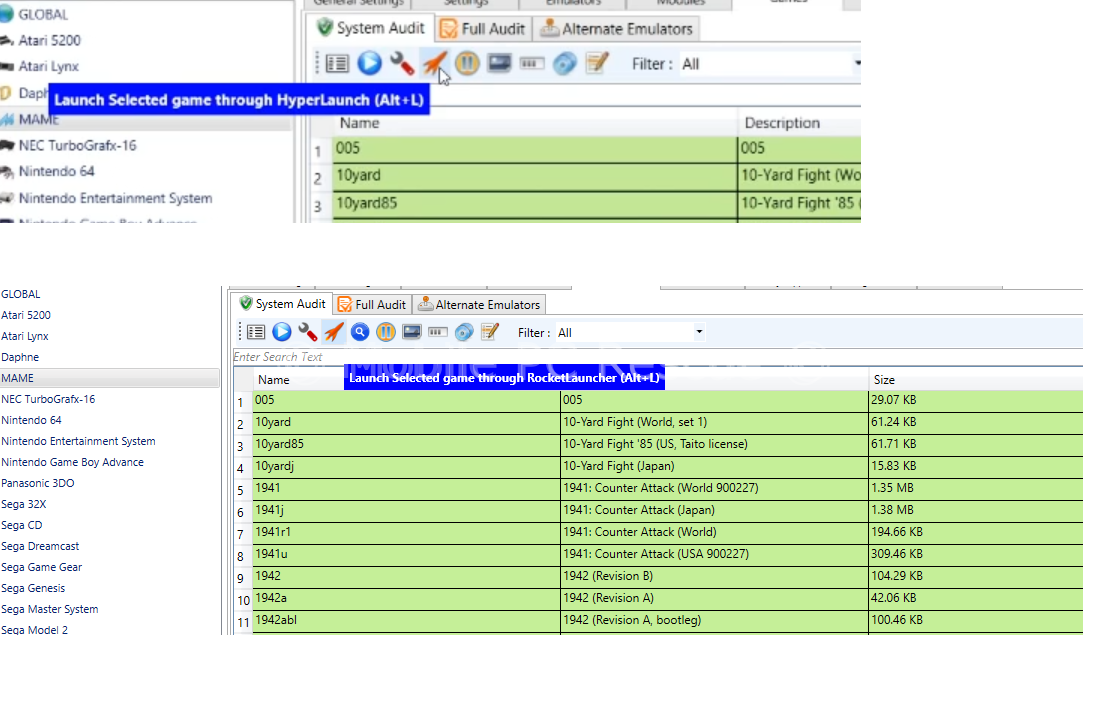

skpManiac Posted April 3, 2016 Author Posted April 3, 2016 The top pic is in the TUT, and the bottom pic is my RL :/

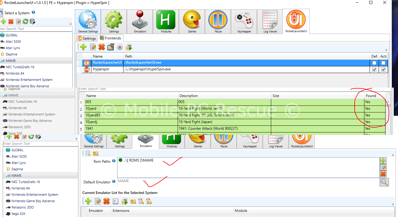

skpManiac Posted April 3, 2016 Author Posted April 3, 2016 ok, I guess I will have to go through the video again and triple check my config From here it all looks right but I am obviously missing a setting somewhere to tie HS to Rl :/

skpManiac Posted April 3, 2016 Author Posted April 3, 2016 If it's still using HyperLaunch, no. The emulator has nothing to do with that. The problem is with the setup of HS and RL itself somewhere. After you renamed your paths did you change them in your Settings.ini and your frontend paths in RLUI? Yes, and double checked and checked again - it seems to be my Mame exe mate :/

skpManiac Posted April 4, 2016 Author Posted April 4, 2016 In Hyperspin, there is only a couple of paths to change I thinkIn the settings.iniHyperlaunch_Path=E:\RocketLauncher\RocketLauncher.exeand in Hyper HQ, under the MAME Wheel ? Have I missed something? Thanks
