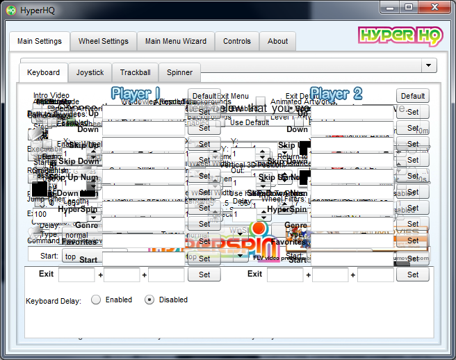

Recently, my HyperSpin collection stopped working for me. It was working at the end of June, but when I have tried to start it lately, it just doesn't work.
When I run the HyperSpin.exe, it shows in the taskbar and the mouse gets confined in a area of HyperSpin display resolution, but nothing else happens. I have tried overwriting the executables with the newest versions, but nothing changes.
HyperHQ also doesn't work, but in a different way - the UI is all mangled (see screenshot) and unresponsive. I don't know if it is connected to previous issue.

Hi,
Someone knows the answer to this problem? I just encountered the same.
Everything worked fine until this morning. Suddenly HS does not work anymore and the HLHQ has mangled text just as described above.
HQ launcher still works and all the games are playable through HQ launcher
No changes or alterations were made by me when this occured (I was just playing with Touhou project)
I am in the progress of 99% of my arcade machine and then this happened...
Thanks for any hint in the right direction!
  • 1 month later...
I too am experiencing the mangled text for Hyper HQ. I am using a fresh install of Win 7 on a new computer with the latest HS file.
If anyone can provide a solution for this I would be most grateful.
Thanks in advance!
I had a similar problem,
I think it was my antivirus, avast to be precise. once I turned that off, reinstalled HS, HQ everything was back to normal. I had the AV running in silent mode so didn't get any warning that it was messing with HS
Are you running the newest beta 1.4 HS? If not then plug in speakers or headset.
Thanks both.
I'm running 1.3.2.0 and the issue was resolved after disabling the firewall/antivirus and reinstalling.
Thanks both for your quick responses and help!
I had the same exact thing happen to me last year, after I installed GIT to get the new RocketLauncher install.  I did a system restore point to before I installed GIT, and that got rid of the jumbled up hyperHQ.  Weird stuff.
