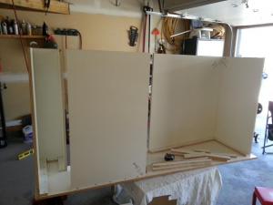

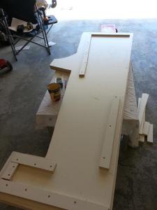

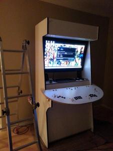

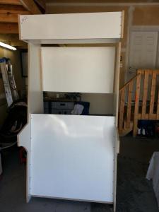

Well it's been a long 3 weeks or so! I started this build Canada Day weekend. I based my build off of the cabinet plans ridicrick included in his origonal post (HERE)

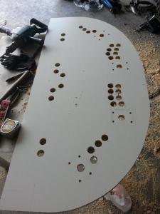

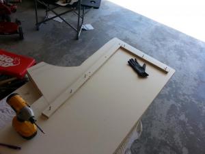

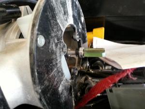

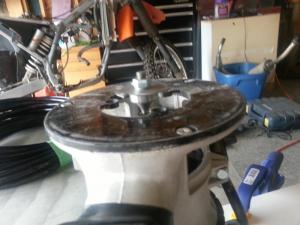

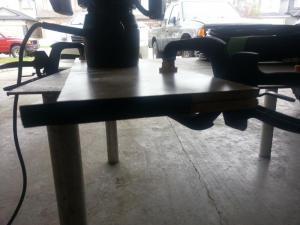

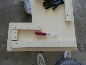

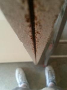

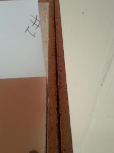

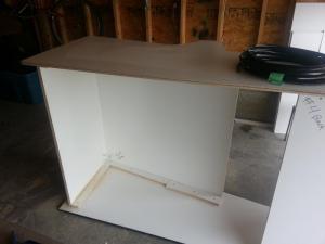

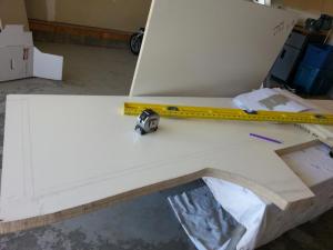

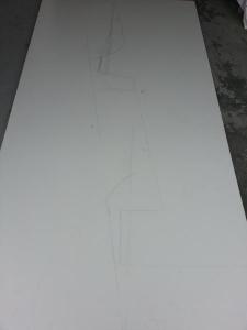

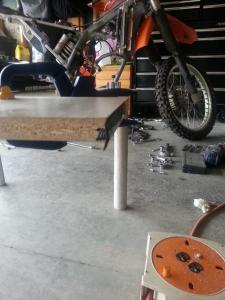

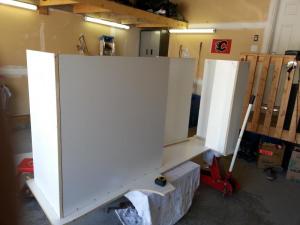

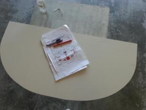

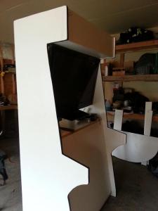

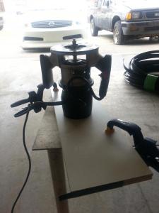

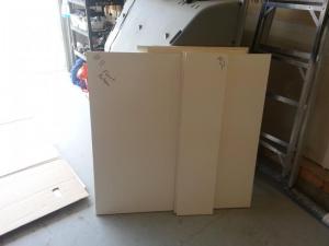

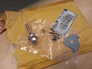

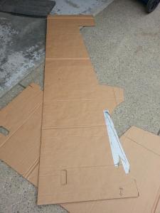

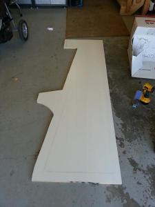

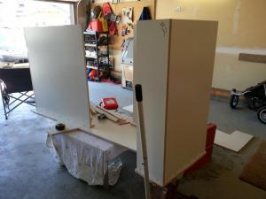

I had to make some changes as I went along as there were some angles and measurements that were unclear. The hardest part was cutting the sides and having them not overlap each other! Man was it tight. But once I had the carboard template ready I was set! I have to tell you, melamine is not the easiest material to work with. It's great for some things, and touchy for others. All I have to say is make sure you have a good quality dewalt ratcheting skrewdriver! They are the best! (stole my brothers) His wood routing with the template bit idea was essential for doubling the sides. The only thing I was missing was the T-Moulding cutter which I bought at GroovyGamerGear. It would have costed me more money to buy it locally than it did online with shipping from the USA.

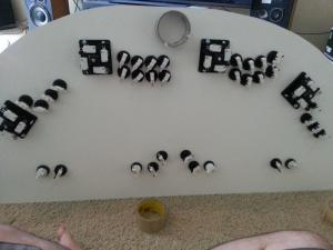

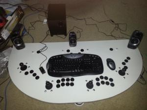

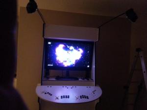

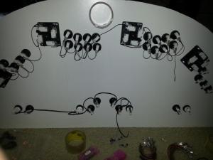

Ok so I have lots of pictures and attachments for reference and I will do my best to explain them. I also have a couple video's that I took when I got the PC working. I'm not "DONE" as I still have to get vinyl for all the white surfaces, the control panel is still kind of a mess and I need to get seating. All in good time though!

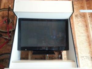

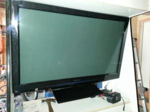

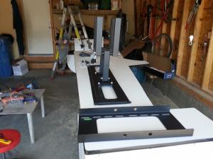

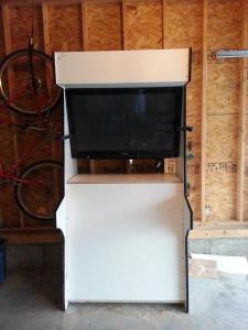

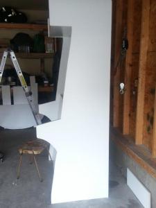

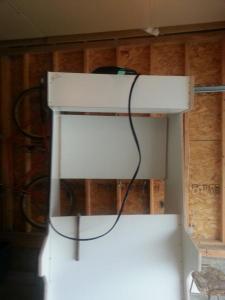

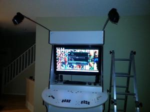

I created a secondary plate that was the size of the mount for the TV. I then mounted that to the back plate to create more rigidity. Once that was mounted securely I attached the TV mount to that piece. I was also able to use the same skrews I used on the cabinet with proper washers. I used A LOT of screws to make sure this was secure. I nearly doubled up the screws into the strips as well without compromising the structure of the wood strips. I am able to (although I don't like to) telescope the Tv past the front of the marquee and it has the slightest bit of lean. I hope that helps!

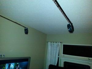

Thanks Zeadlots! so you basically doubled up the mdf for the tv mount which was attached to the back wall of the arcade. I didn't even think about the lean that is another thing that is easy to forget given the dimensions of this bad boy. Your hanging speaks don't really help the situation. I'm guessing your sub in the bottom of the cabinet helps counter that lean a bit.

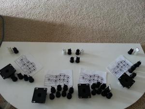

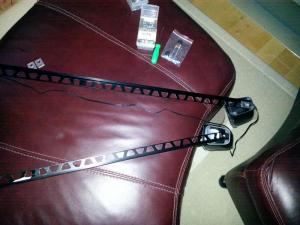

Where did you get the keyboard rails and I guessing you attached those to your mdf strips as well. Are you going to get some cool lighting on this cabinet as well?

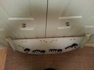

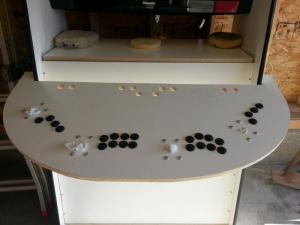

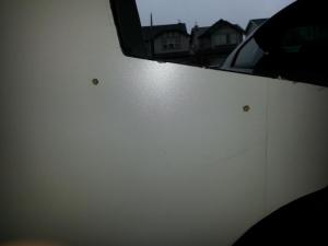

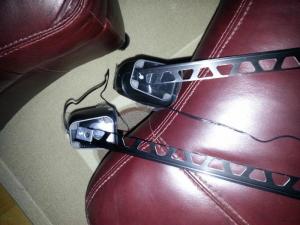

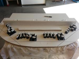

I'm sorry by lean I'm talking about the stress on the TV mount. If it was an LCD it probably wouldn't have been an issue but I ended up with a plasma which are heavier than LCD tv's. The cabinet itself is very well balanced and is heavy enough that there is no risk of tipping or leaning. The speakers hanging are so light they might as well not be there. But they get the job done that's for sure. As for the keyboard rails, I didn't use any bracing at all. I just had some shorter screws and used those as to not go all the way through the melamine.
I believe my next venture will be design some vinyl, it's probably going to be a 300$ + dollar step so I want to make sure I do it right and can live with what I pick for art. I'm a huge streetfigher and capcom fan so there's lots of art out there for me! Thanks for the compliments.

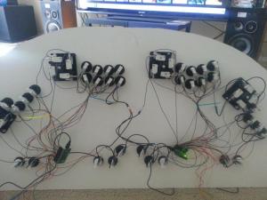

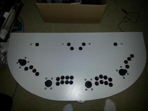

I've quickly come to realize I can't work photoshop to save my life. I am now looking locally for a graphic designer to help me with my artwork for the cabinet. I will also be looking on the forums for more info. If any of you know of a youtube how to or a resource to map out cool looking controls I'd be very interested to see.
