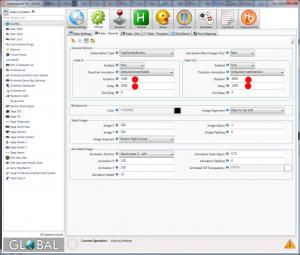

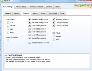

gigapig Posted July 22, 2013 Posted July 22, 2013 Quite possibly these settings. Yours must be set to around 10,000.
monkeychunkuk Posted July 22, 2013 Author Posted July 22, 2013 i don't have that menu style im using the older version so i guess its in my setting?
gigapig Posted July 22, 2013 Posted July 22, 2013 If your on Hyperlaunch 2, then you wont be using fade. So the problem would be something else. What do you run on your bartop?

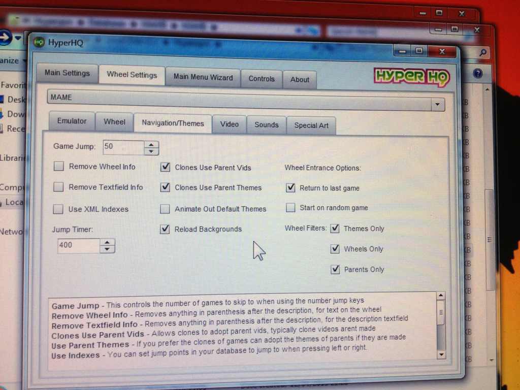

monkeychunkuk Posted September 13, 2013 Author Posted September 13, 2013 Ok for others that may have the same problem I tweaked this settings and it solved If someone in the know could tell me why that would be great

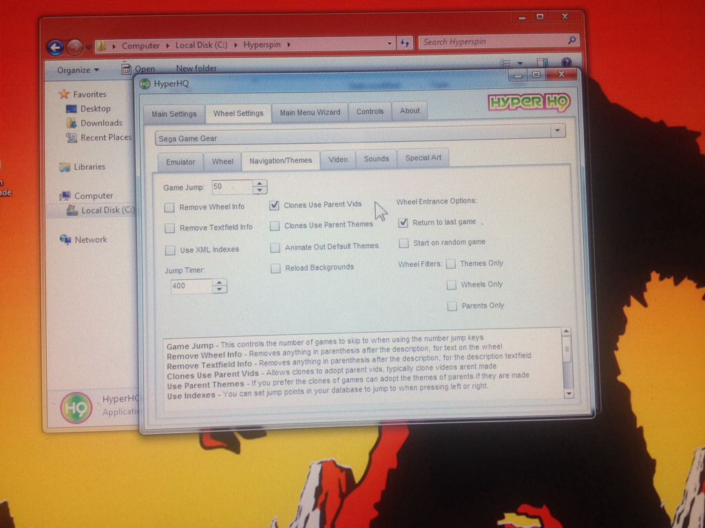

gigapig Posted November 1, 2013 Posted November 1, 2013 Do you have the same things checked for every other wheel. Have you unchecked all of those and tested? If the works you should create your own xml then there would be no need to filter, if that is the problem that is.
monkeychunkuk Posted November 1, 2013 Author Posted November 1, 2013 Do you have the same things checked for every other wheel. Have you unchecked all of those and tested? If the works you should create your own xml then there would be no need to filter, if that is the problem that is. I'll check and get back to you

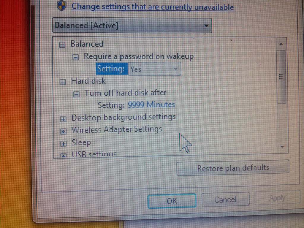

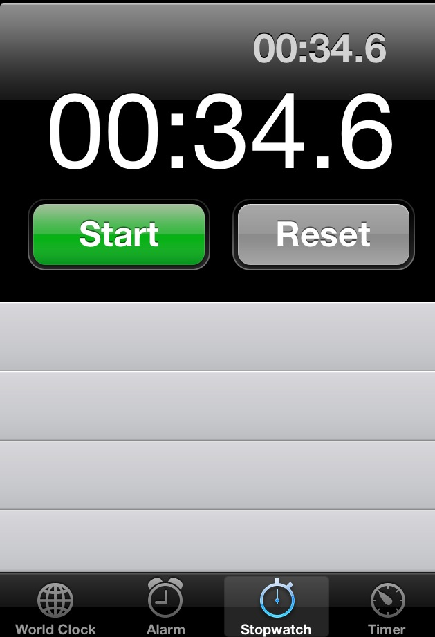

monkeychunkuk Posted November 5, 2013 Author Posted November 5, 2013 Ok done things I've done Changed the power setting to make sure the hard drive isn't turning off Matched some settings to other non delayed Wheels But I'm still getting a delay but now it's random some games go back to the wheel instantly Other take from 20 seconds to 2 Minutes ?? It seems to be the longer I play the game the longer it takes to return back to main wheel I have the latest version of mame?
