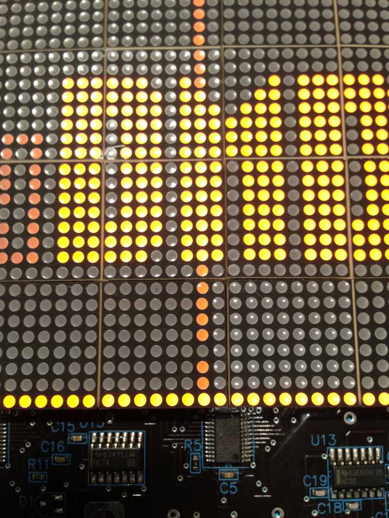

zeenon Posted July 29, 2013 Posted July 29, 2013 After running strong for about a month, I turn the cab on today and have the dreaded vertical line....so pissed!!!!! Z

russdx Posted July 31, 2013 Posted July 31, 2013 Dead pixel shorting the whole column out These Matrix LED's displays suffer quite badly from this I guess this is one advantage of the new pinLED displays they have socketed led matrix segments, so when some thing goes wrong you just pop the dodgy segment out and send it back to pinLED and they will then send you a new one.
zeenon Posted July 31, 2013 Author Posted July 31, 2013 Russ, Is that the cause, because I don't see a dead pixel? (When I think of a dead pixel, I think completely out) just curious Z
scottpe Posted July 31, 2013 Posted July 31, 2013 Is that the cause, because I don't see a dead pixel? (When I think of a dead pixel, I think completely out) I think by 'dead' Russ is basically saying a 'bad' pixel. Bad pixels can be totally dead (always off) or stuck in the on position.
russdx Posted July 31, 2013 Posted July 31, 2013 yeah some times completely unlit but some times half lit, If you run one of the roms DMD test, when it lights the whole DMD you should see 1 pixel in that column doing some thing weird hehe.

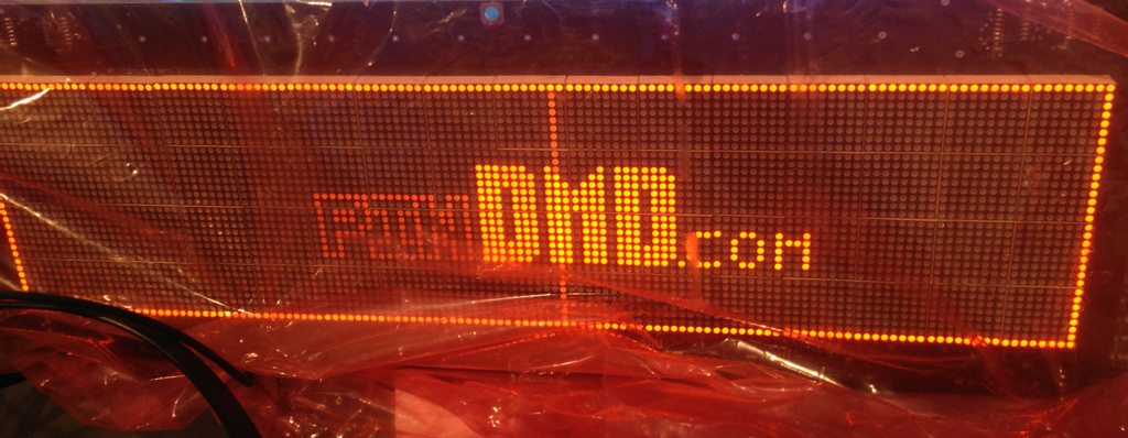

neohusky Posted August 1, 2013 Posted August 1, 2013 Here was mine. To know, is to know that you know nothing. That is the meaning of true knowledge.
