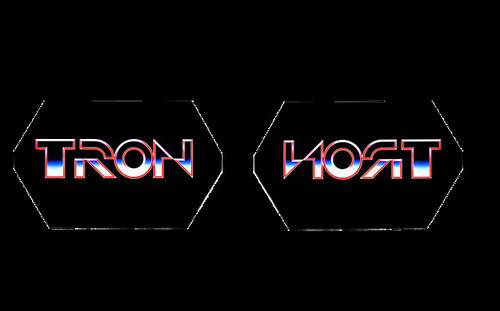

here is an example of what I mean...
the left image is normal, the right image is Planar Mirrored

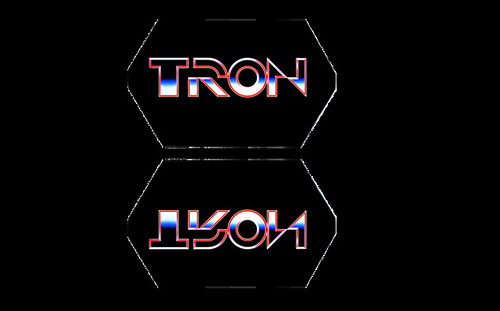

this one, the top is normal, the bottom is Planar Mirrored Top/bottom
